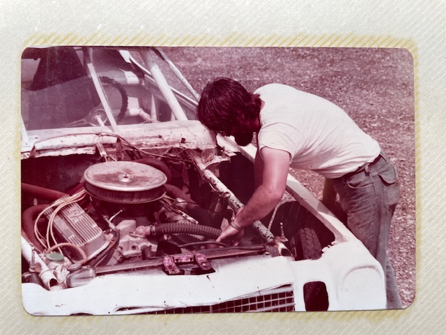

Here I am working on the problem before the heat race.(once again)

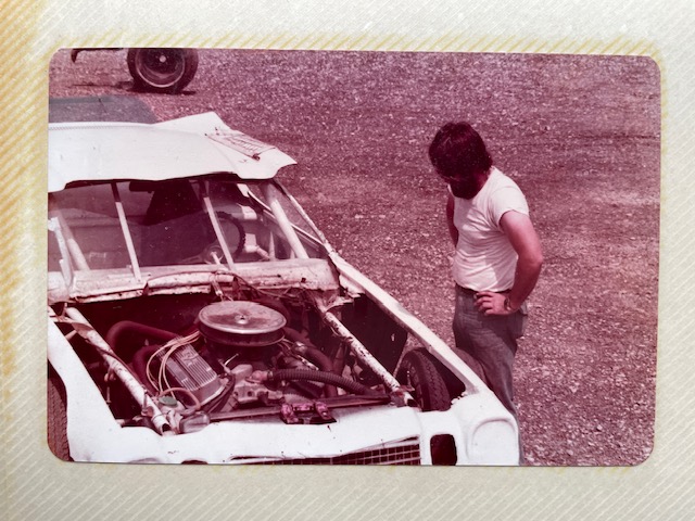

Here I am just looking at the problem and just saying to myself SCREW IT.
