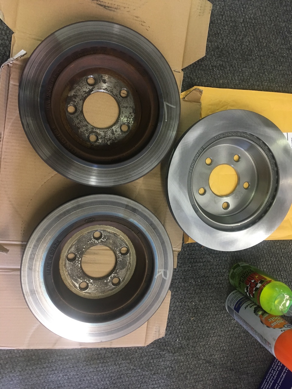

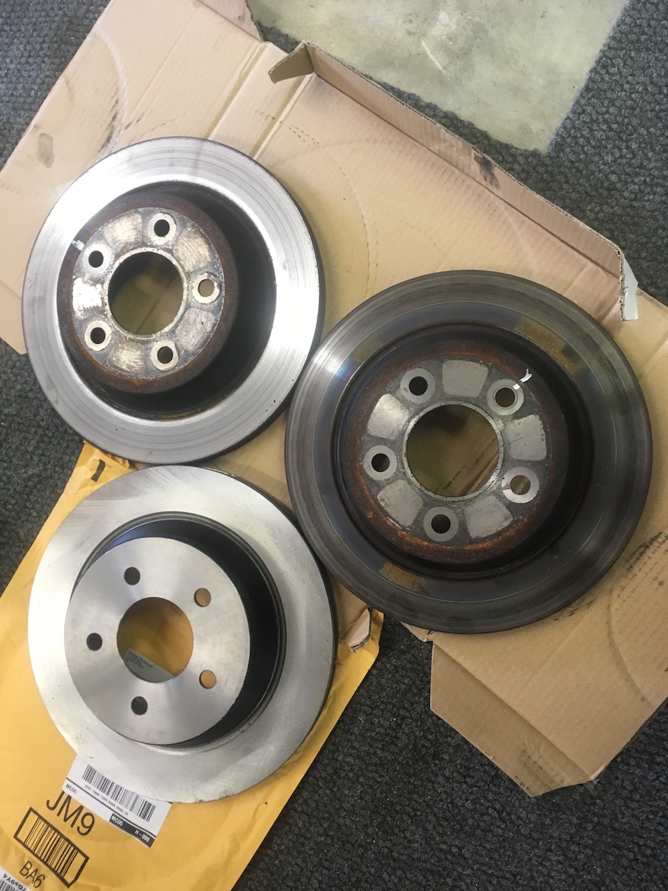

Preparing for the track day: redo the brakes.
I just finished (except for bleeding the brakes) putting the new rotors, calipers and pads on the rear of the wagon. The front will get new pads and rotors tomorrow - at least that's the plan.
When Herb and I did the rears last time he was here it was a circus: bad calipers, two different thicknesses of pads and who knows what.
Anyway, last track day (SCCA PDX) the braking was lousy (yes, that's a technical term). If you look at the video in that thread you can see the G levels were not good during braking. Maybe 3 or 4 tenths of a G. Cornering and acceleration were OK. Cornering touched 1G in places, very satisfying. And a little scary...
The rear rotors looked unevenly worn radially. Pictures below show that was not an illusion. They were worn partially and turned blue from heat in narrow bands. You can see this in the pictures below: Both rotors are shown alongside a new one. The areas where only part of the pads were against the surface are visible, along with some bands of discoloration where the heat level got out of hand.
I really hope the new parts will be better!
