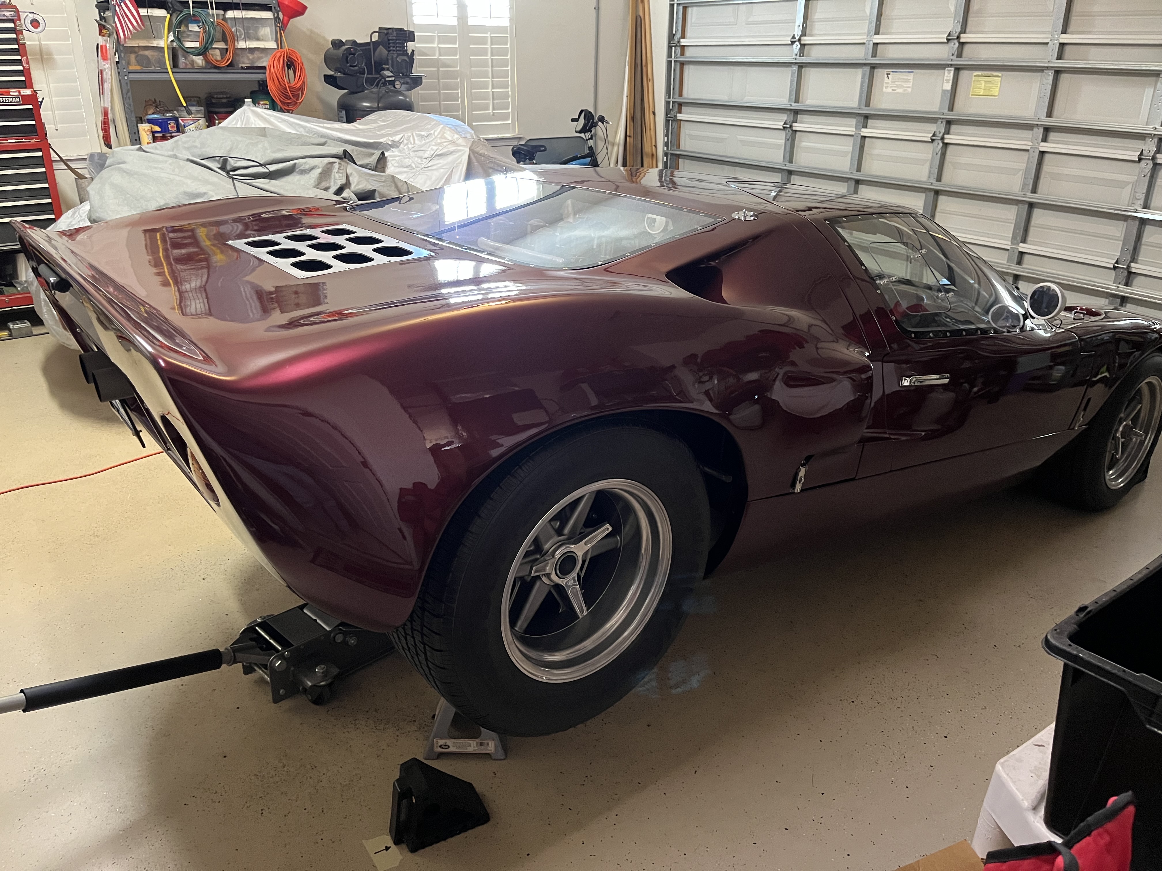

Thx Will, but I think I declared victory on that WP hose too soon. I’ve noticed its still weeping.
I’ve had the car out a few times, and it’s running okay, making good power. Lots of sorting to do. Tracks straight, but there’s a bit of hysteresis in the steering due to slop in the wheel’s quick disconnect. It’s annoying, not sure yet what I want to do about it.
Water temp sat at 180 for a few miles and then climbed to 200, probably due to low water level. I had to run the fans to hold it there. I drove down to I-95 and decided to turn around out of fear of a possible overheat, since the fans weren’t bringing the temps down. On the way back, I started to hear what sounded a bit like belt squeal, it got louder with higher revs. Not sure what it was. When I got home, I got a whiff of coolant, but nothing was leaking under the car. Maybe a bit of coolant got onto a belt? IDK, belts are not loose. Got to get more miles on it to get things sorted.
Anyway, I jacked up the car and put a few more turns on the clamp. I think I’ve tightened it as far as it can go. I have the next size smaller t-bolt clamp, which I can try if it continues seeping…
