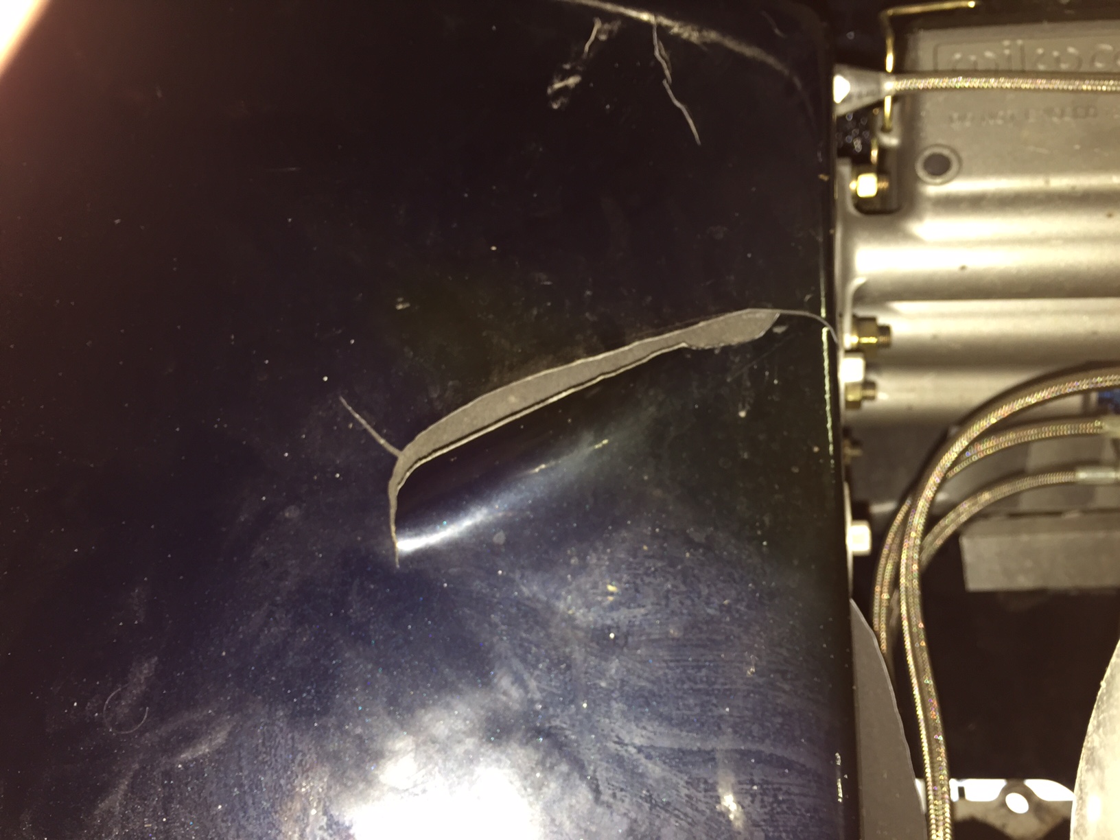

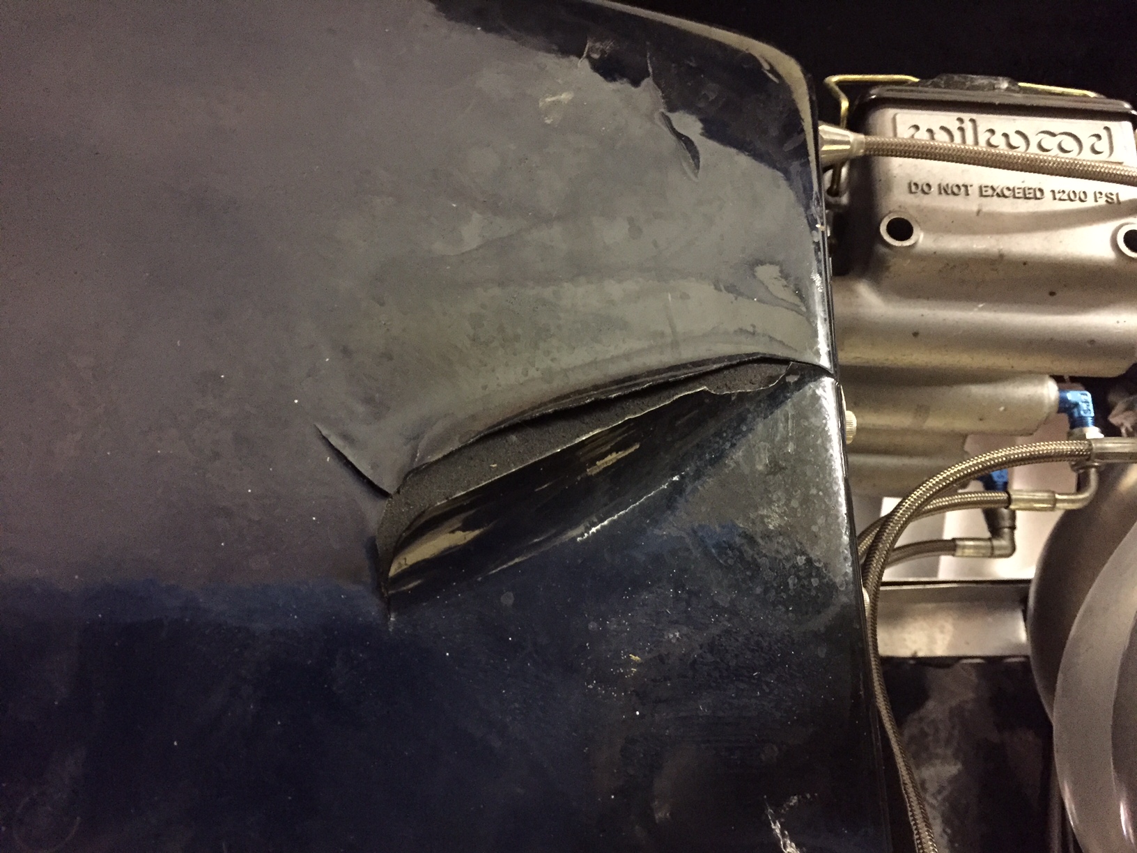

While cleaning the engine bay while the motor was out I found Heat Damage to the foot boxes. I used Lizard Skin heat undercoat but I painted over the top. The undercoat did its job but the paint gave up.
Heat Damage
Heat Damage
Heat damage
Heat damage

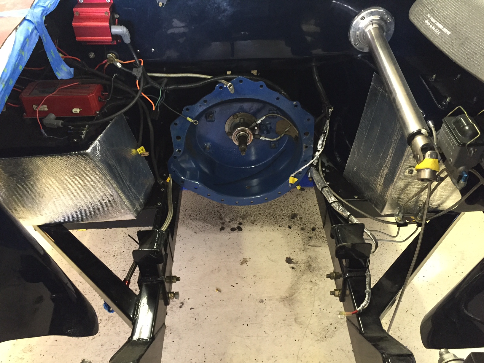

I added heat shield from Summit Racing.
Heat Shield
Heat Shield

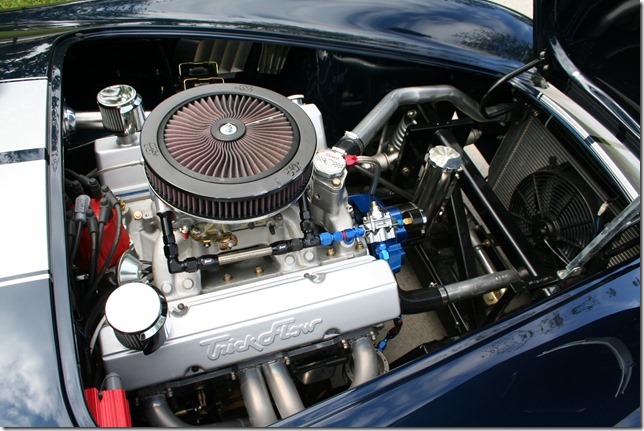

Here is the old breather system. Looks cool but it leaked, even with baffles and a air filter pre breather sponge that I took from my Lawnmower's air cleaner stuffed in.
Old Breather
Old Breather

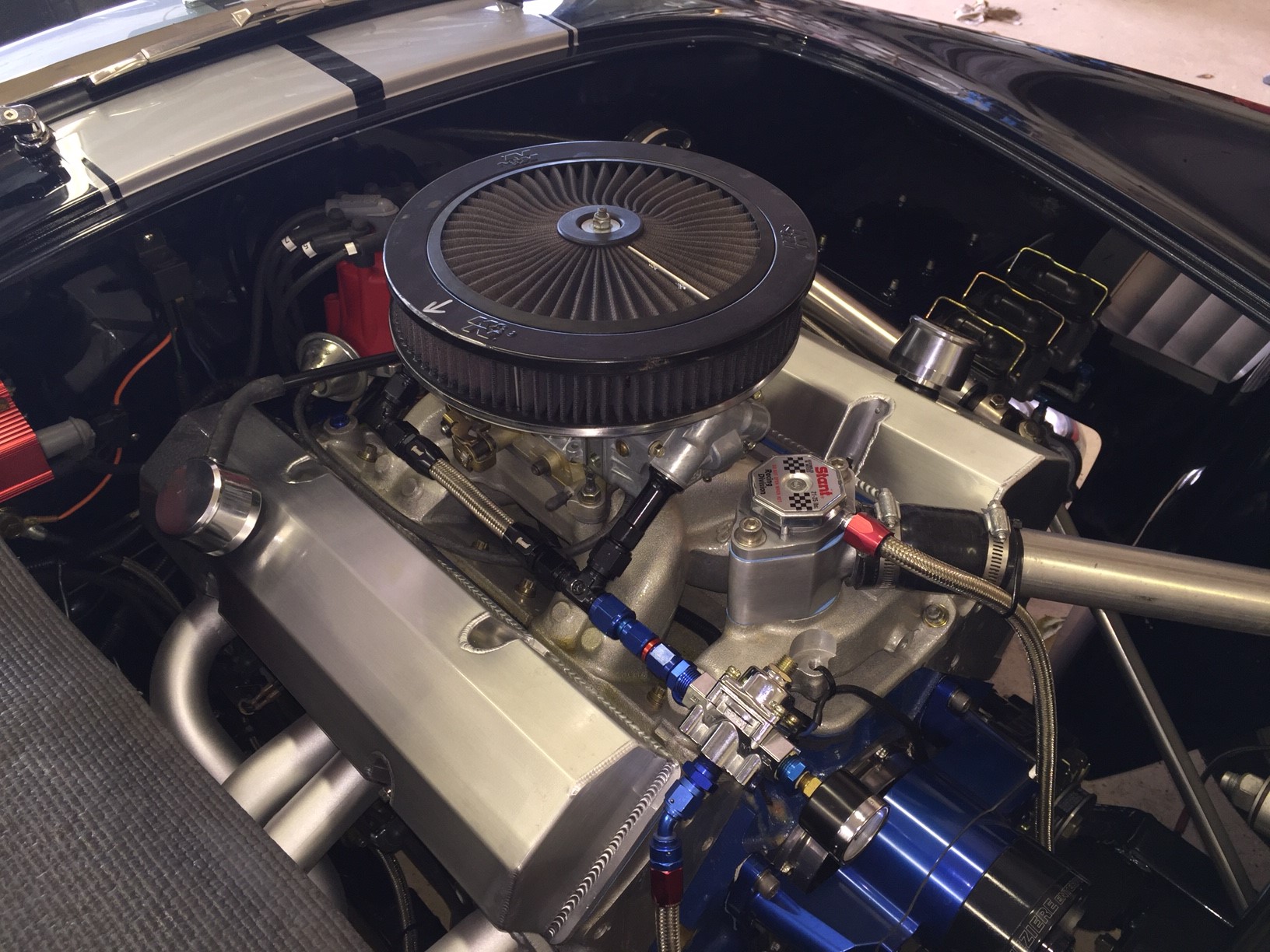

This is where I ended up.
All done
All done

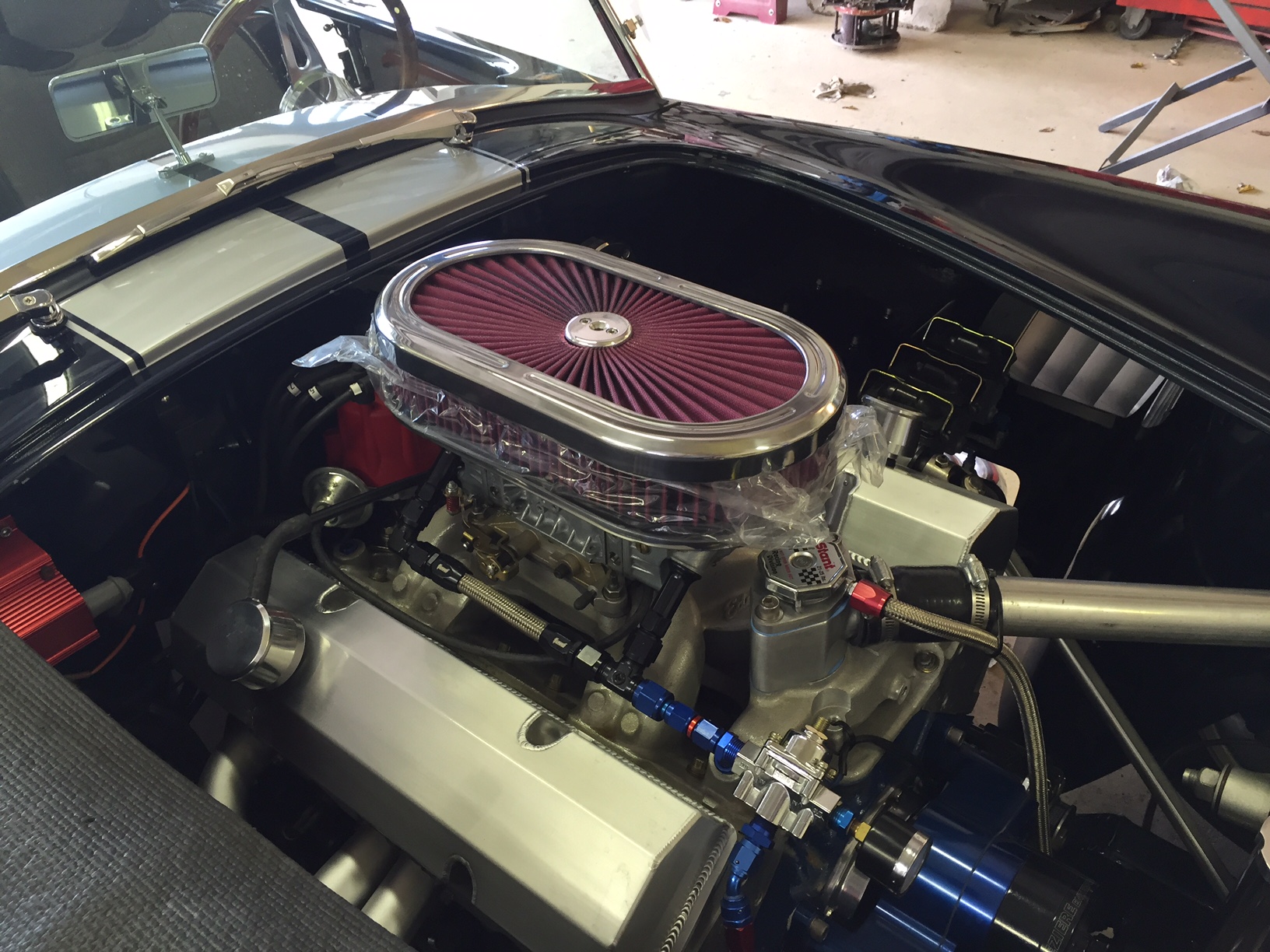

Old air cleaner, new valve covers with PVC system connected and Headers re-coated with ceramic.
I also moved my vacuum advance from ported to manifold vacuum. This fixed a LOT of problems. My plugs always looked rich. Even when I knew that I had it jetted too lean. Once I changed the vacuum the plugs got real white right away. I raised the jets 5 steps and all sorts of drivability issues went away. The manifold vacuum increased the idle advance around 15 degrees. Max advance stayed the same when accelerating.
