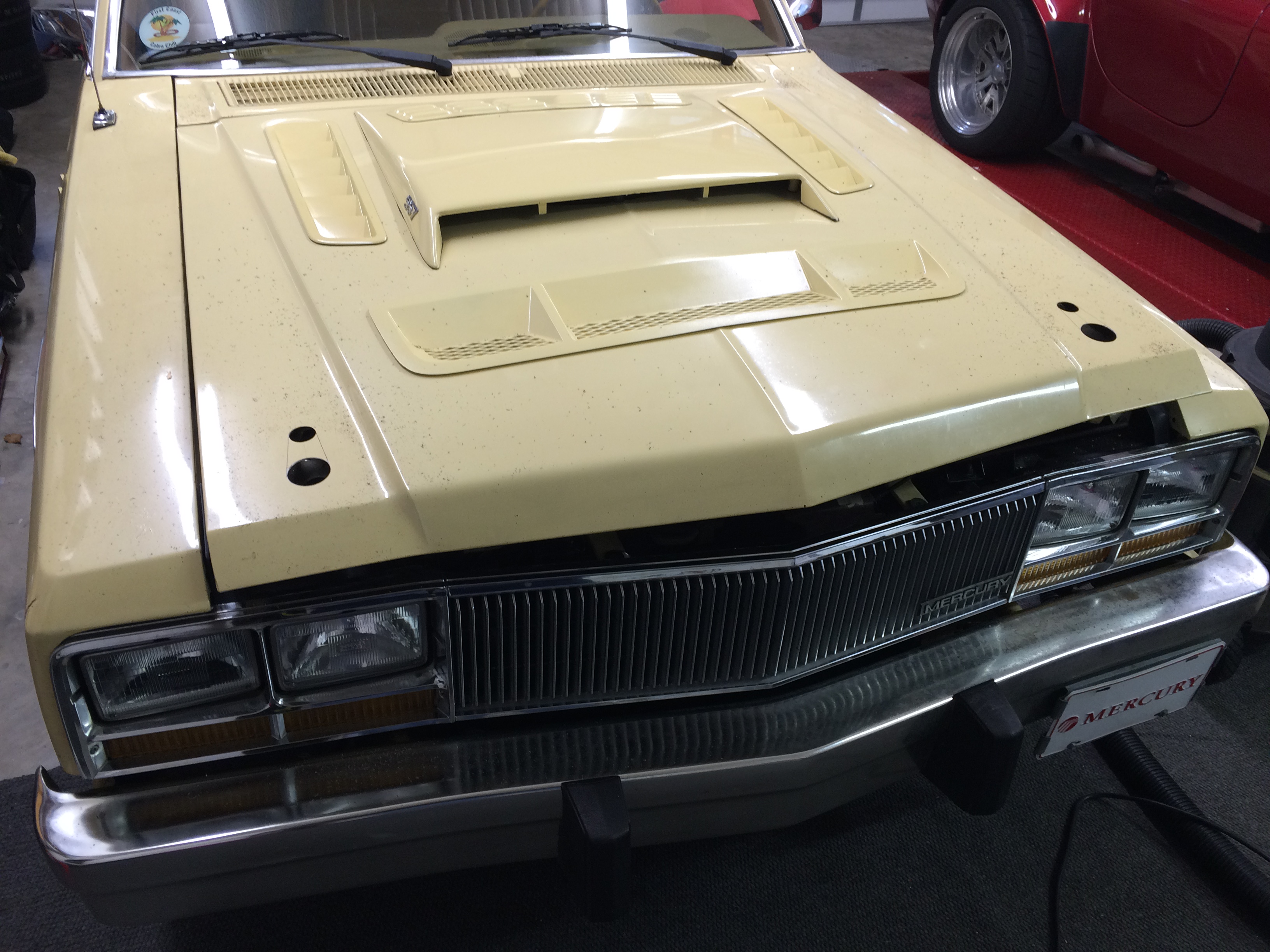

First, we had to decide location. Since the hood bumpers on a lot of Ford products and also the Zephyr are located fortuitously, we decided to use the existing holes. The bumpers were removed, and then with some difficulty, the captive nuts. The slots the nuts came out of were quite usable.

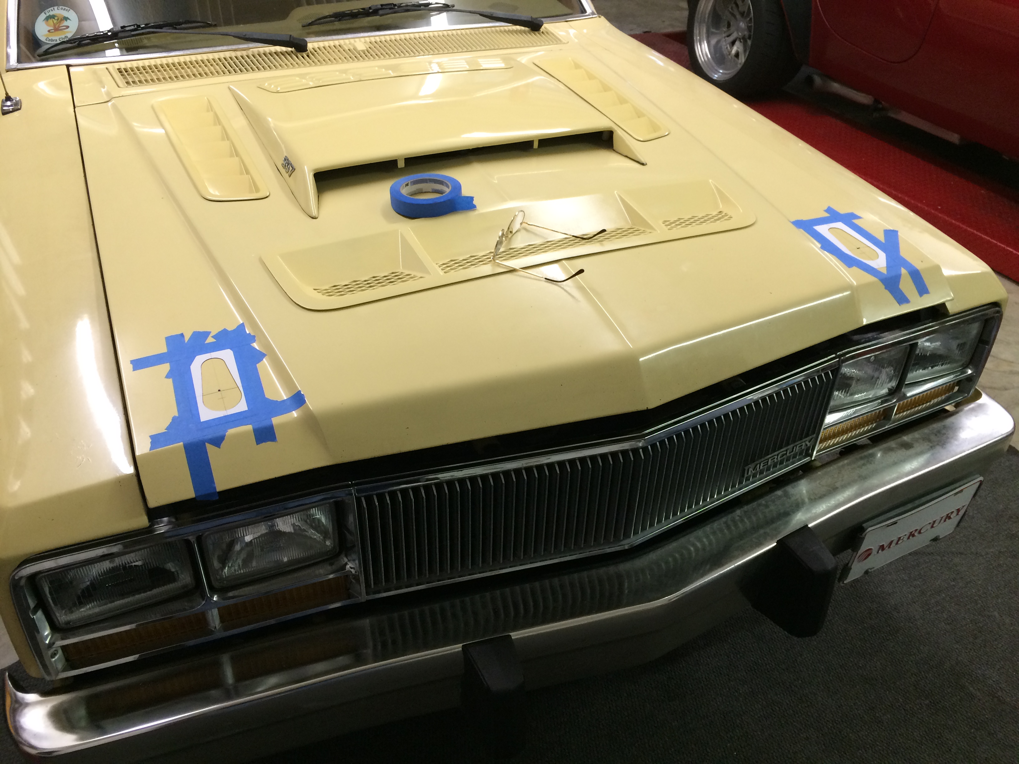

Then we had to locate where the holes in the hood had to be put. This was a little bit interesting, but yielded to our intellects when we decided to use a 1-1/4" holesaw to remove the lower part of the double thickness of the hood structure that was there. Then we put a stud in the slot, approximately centered in the holesawed hole and lightly closed the hood on it.
The mark on the underside of the hood was used to drill a 3/32" pilot hole to use when placing the template for the latch itself. There are crosshairs on the template that crossed at the drilled hole:
Hoodpin templates.JPG (1.63 MiB) Viewed 3573 times
You can just see the small holes where the template lines were marked onto the hood.

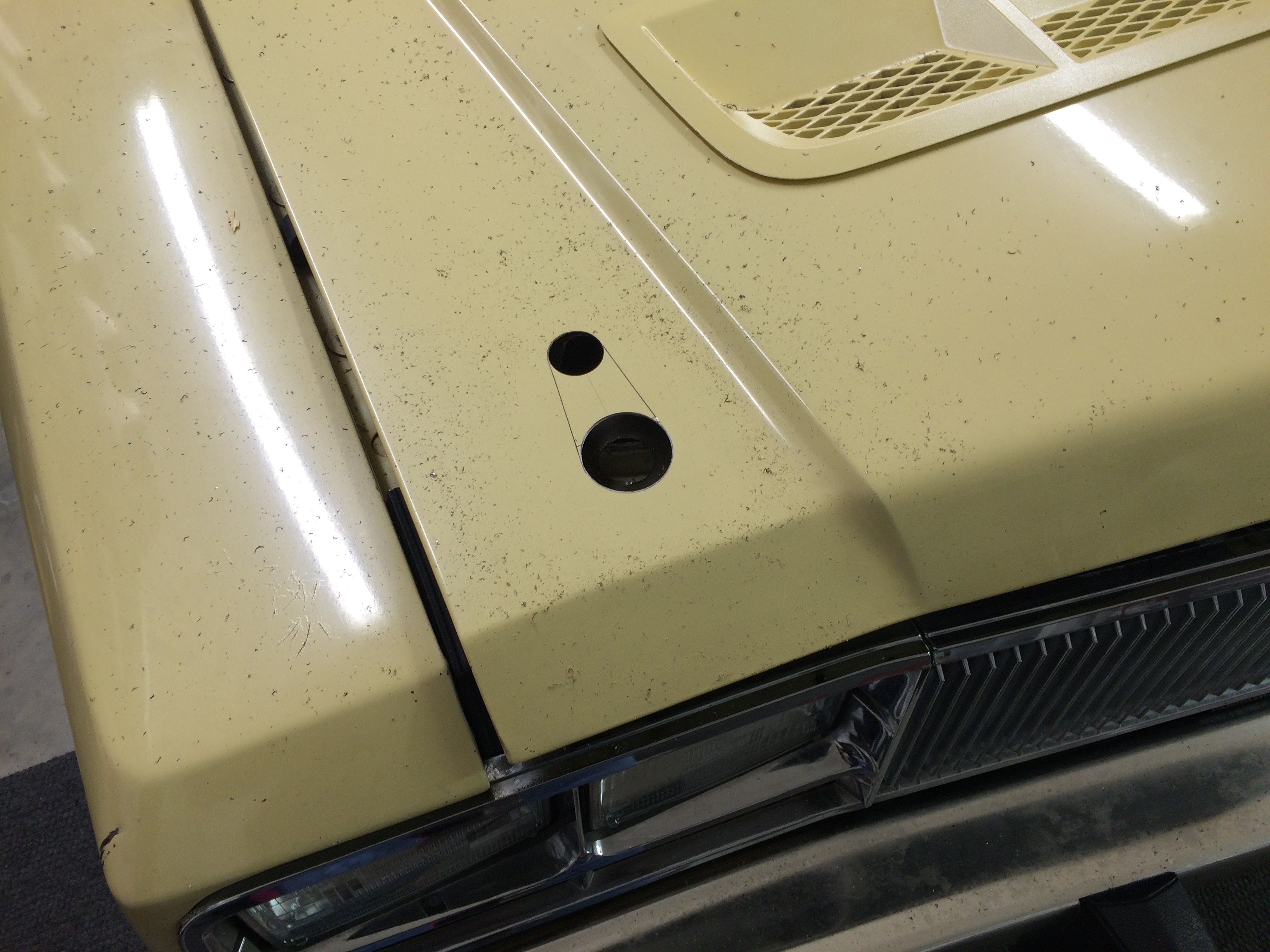

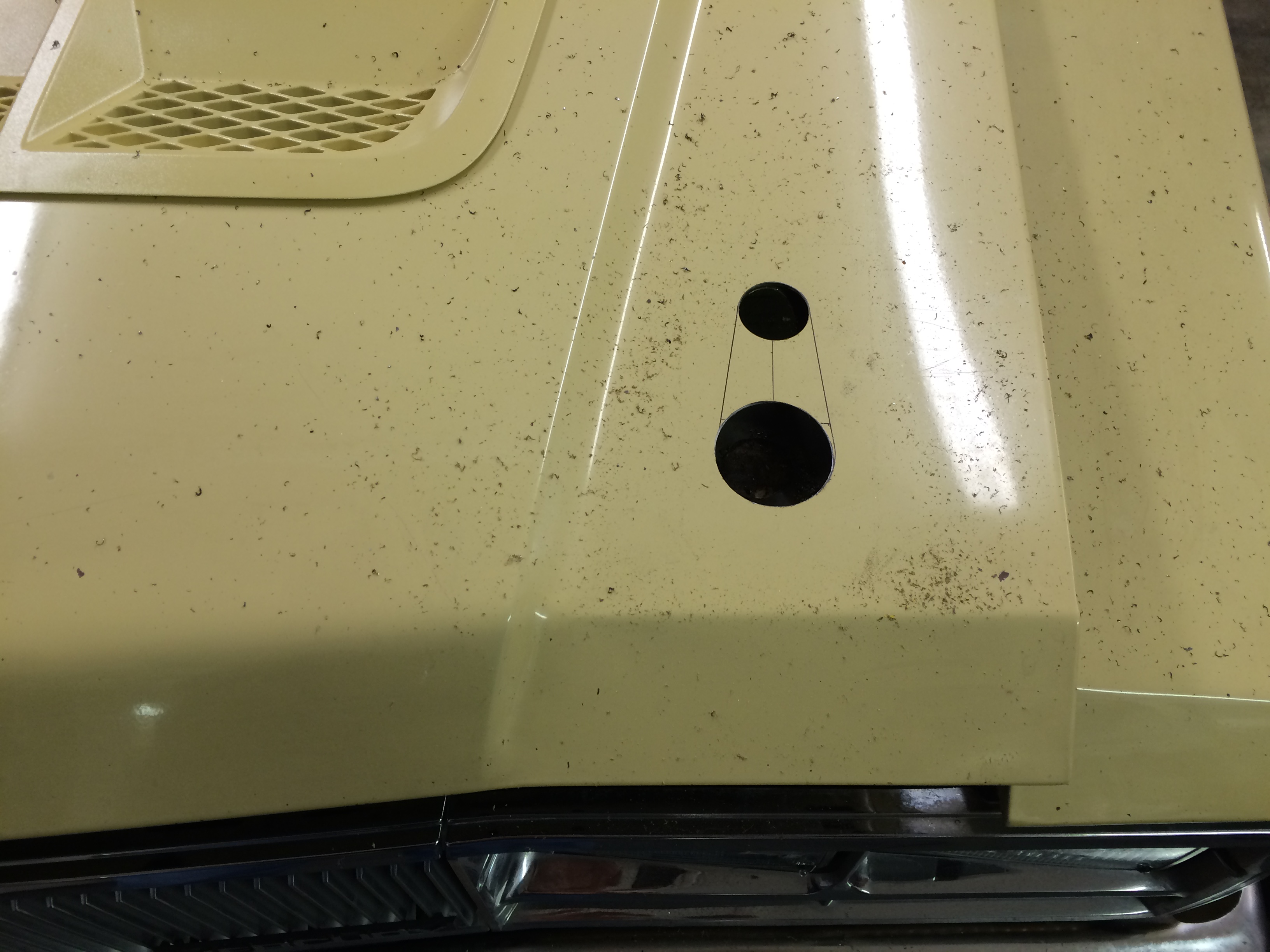

Then the holes were holesawed, the smaller were 1-1/4" diameter, the larger were 1-3/4" diameter:
Holes sawed closeup left.JPG (1.56 MiB) Viewed 3573 times
Holes sawed closeup right.JPG (1.12 MiB) Viewed 3573 times
Hoodpins holesawed.JPG (1.74 MiB) Viewed 3572 times

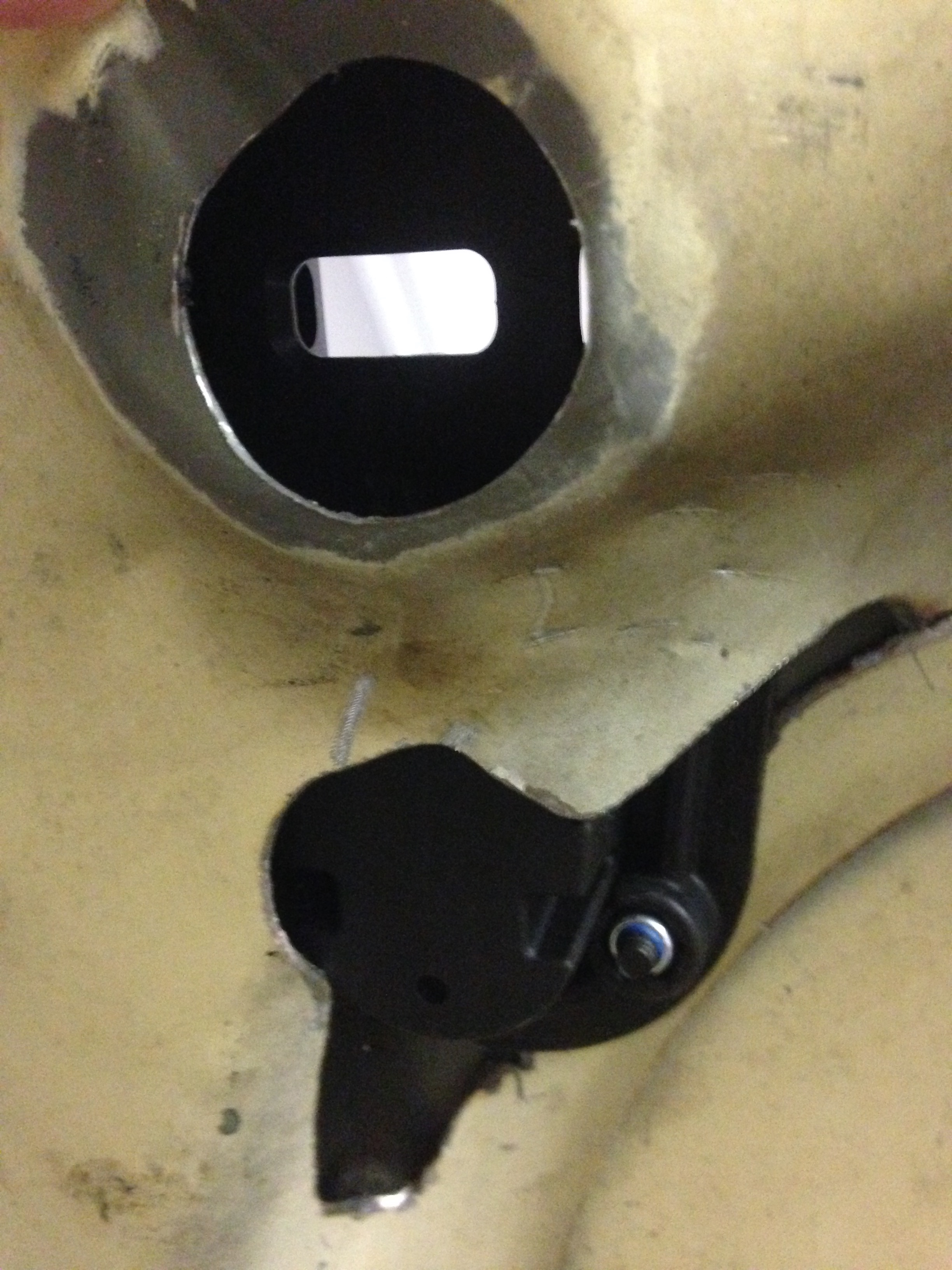

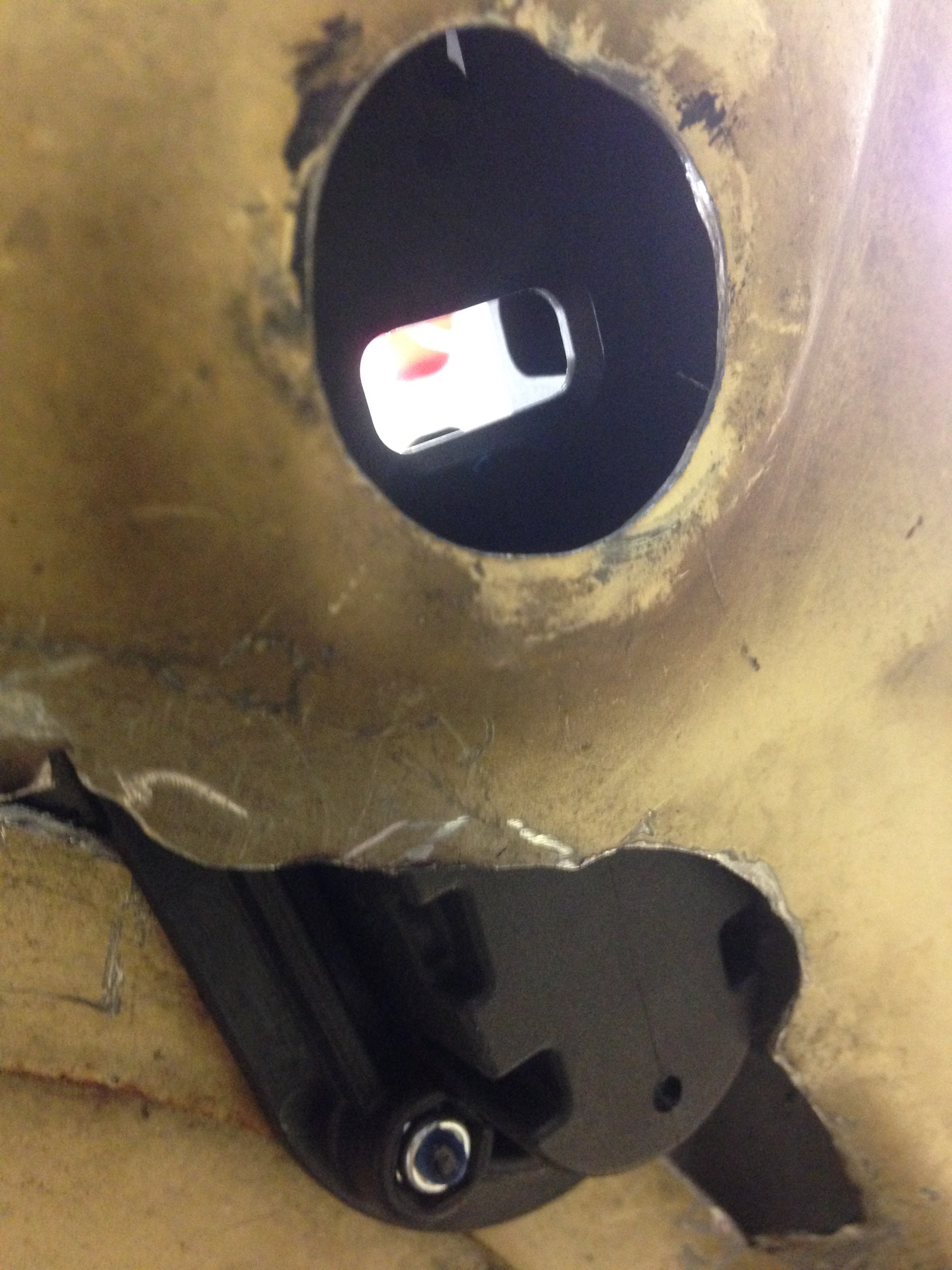

Lots of work went into making openings below the template holes so the backing plates could be slid into place and installed:
Left catch.JPG (1.26 MiB) Viewed 3572 times
Right catch.JPG (1.39 MiB) Viewed 3572 times

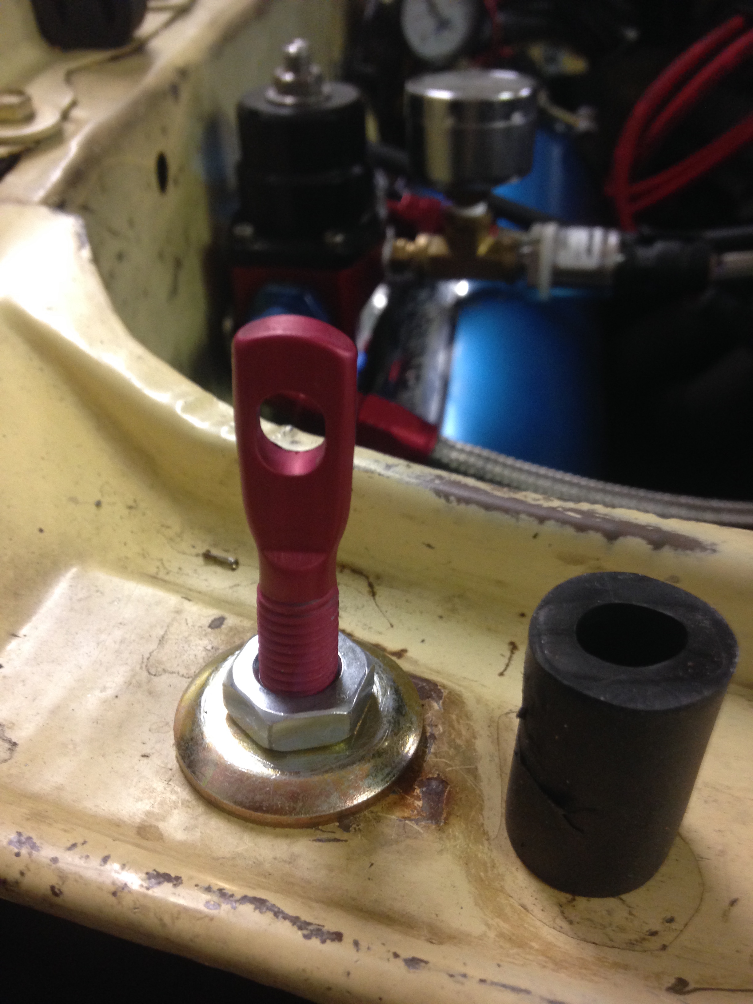

The hood pins were next. Shock absorber washers were perfect for the job:
Bare Hoodpin.JPG (1.6 MiB) Viewed 3572 times

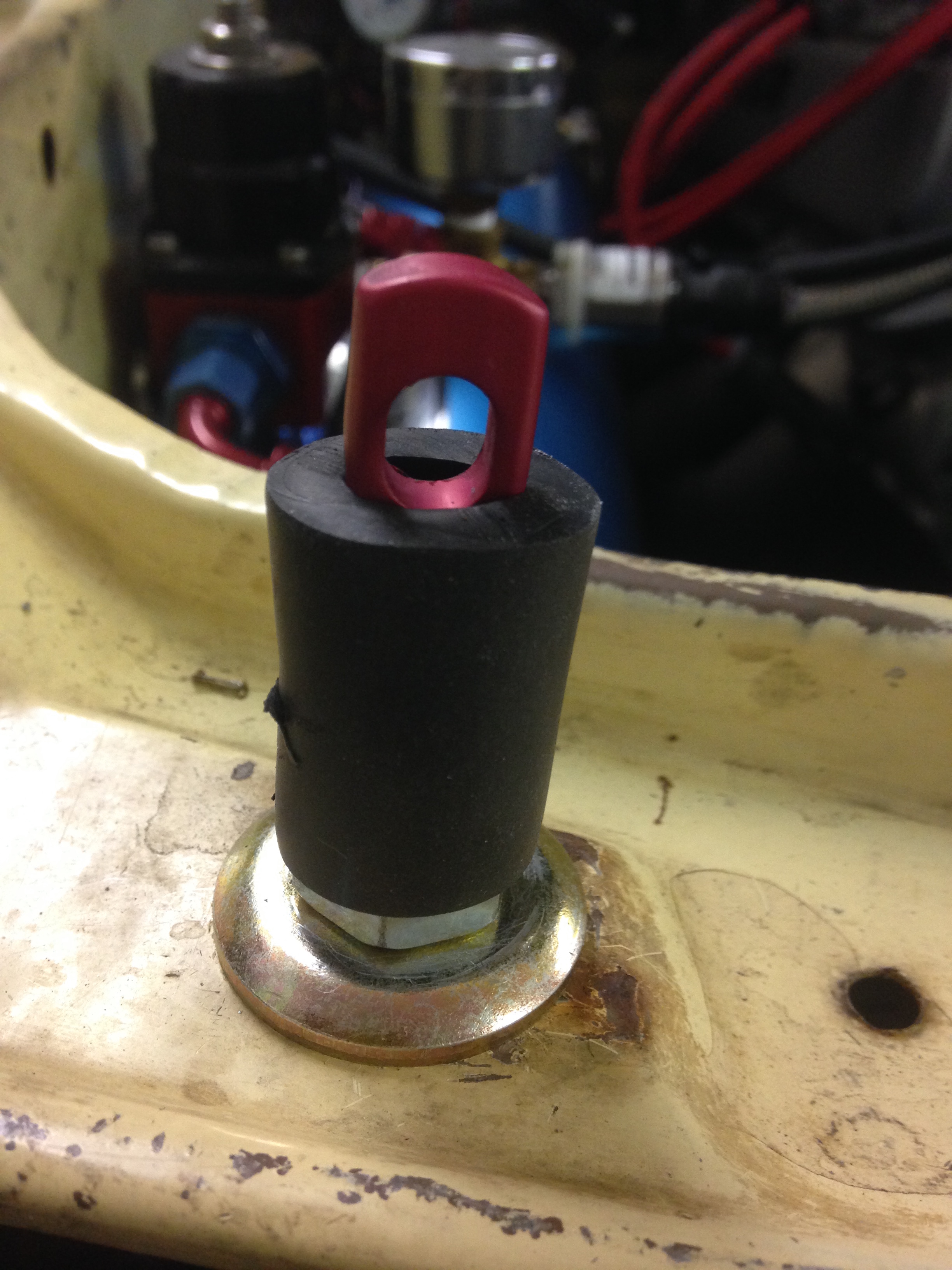

The rubber bumper tubing was supplied with the kit:
Rubber on hoodpin.JPG (1.66 MiB) Viewed 3572 times
Both the pins and the shock absorbing tubing needed cutting to length after the top parts of the latches were installed.

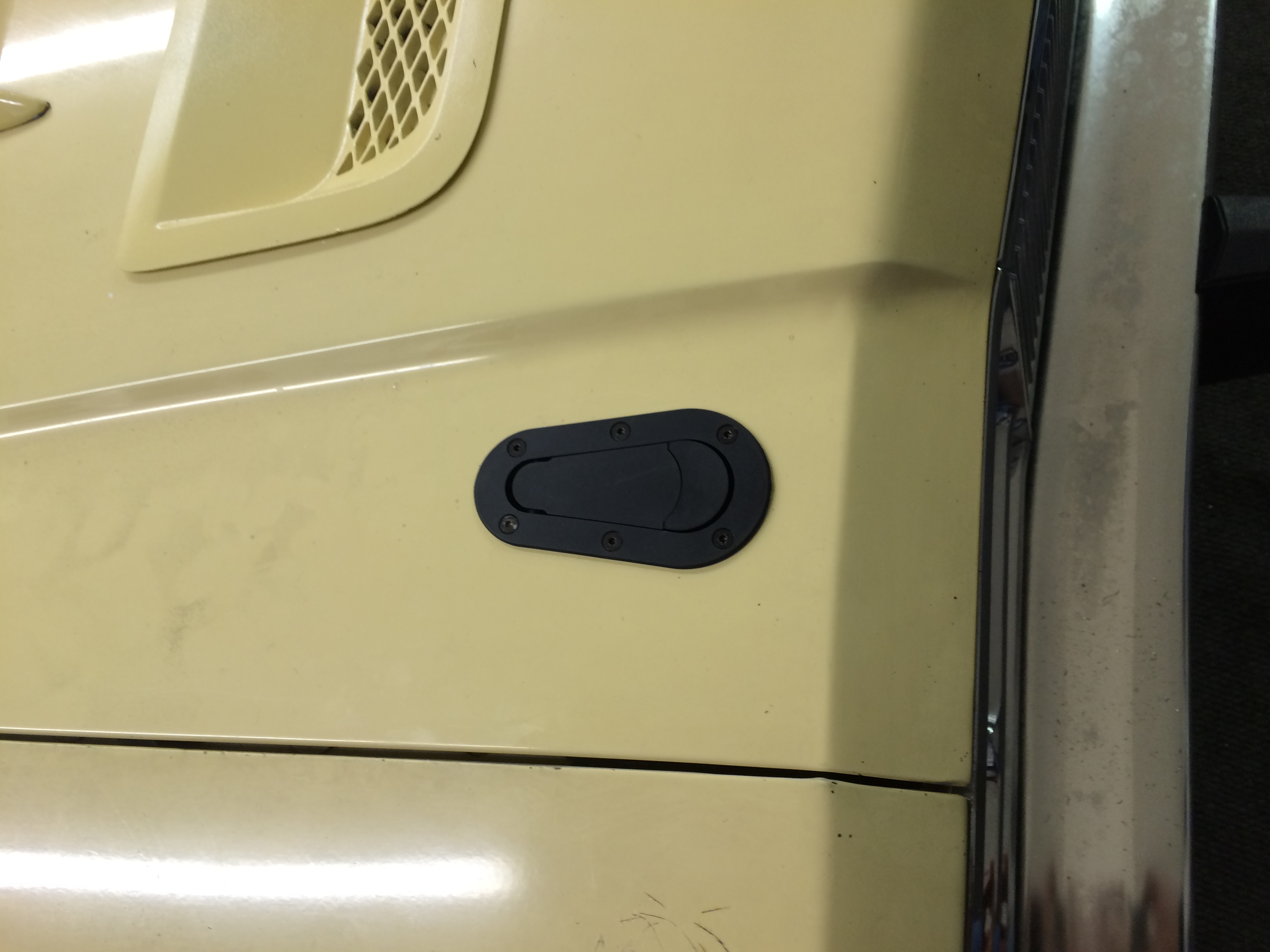

Here's the final external view:
Finished catch.JPG (892.65 KiB) Viewed 3572 times
