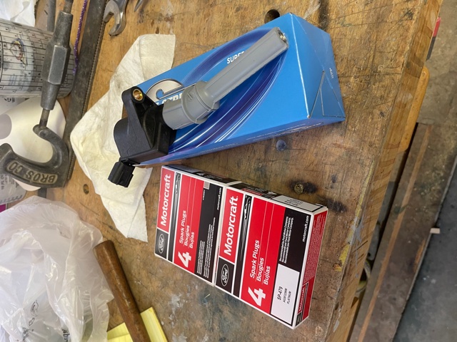

After connecting the scanner, up popped a "misfire on Cyl #1" code. As the ignition system has been untouched sense new (2001 model and 110,000 miles) I really wasn't all that surprised. So off to the parts store and got plugs and a coil pack. I was pretty sure it was the coil back and #1 happens to be the easiest one to get to, so I did think about only doing the coil, but I do plan to keep it so plugs it is.

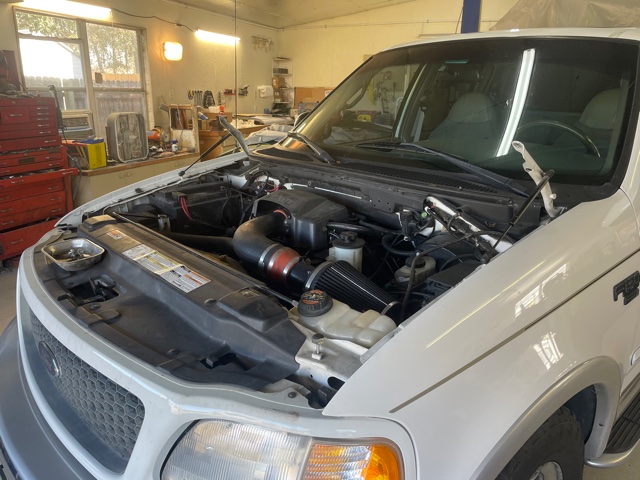

I had replaced the A/C parts this summer and fought it with the hood on so the first thing I did was take the hood off...that was a good call. While it can be done with the hood on it would have taken lots more bending and crouching than a man of my years wanted to do..(and the hood is aluminum so not that bad to get off with help).

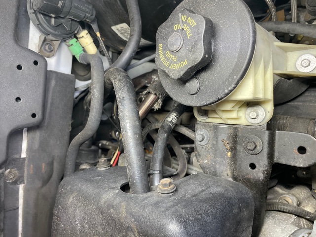

passenger side

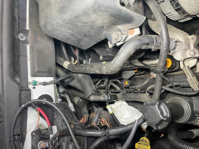

drivers side

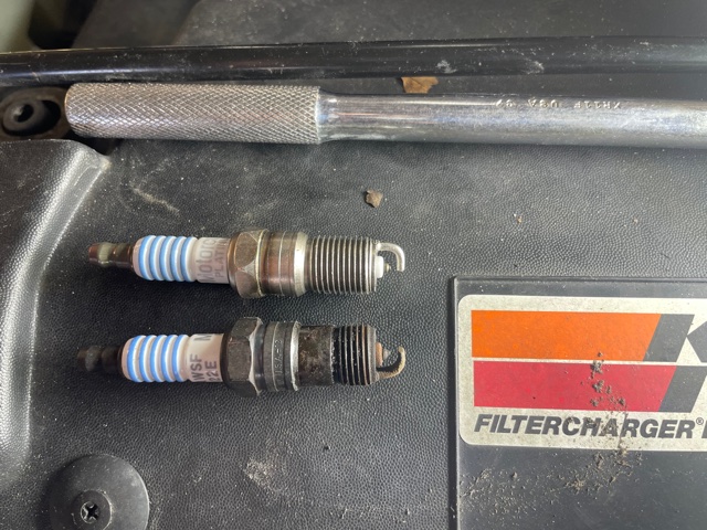

After pulling #1plug I noticed a bit of difference with the threads.
So back to the parts store to see what's up. They did more searching and pulled another plug from stock that is also used on the 5.4 and it too has threads all the way to the middle. So back to the shop.

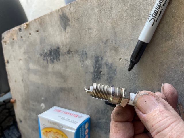

I took a marker and blackened the mating flange and tightened the plug and it indicated that it is seating as it should so I when on with the install.

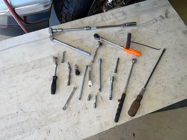

Here are most of the tools that I needed to get the coil mounting bolts and the plugs out. I think I used every floppy and swivel that I had to get it done.
As it worked out I was able to get all the plugs replaced today and the right side all reconnected with the coil pack and injector terminals that had to be removed for access to the coil hold down bolts..Plugs are in on the left side but I saved putting in the coil hold down bolts (the bolts are the hardest part) and wiring till tomorrow.

BTW I don't comprehend the spark plug thread length question. The plug that you removed is on the left of your picture? If so the one that is fully threaded would maybe hit the piston if it went in apparently another half inch or therabouts it would seem.

Yes the plugs are a bit strange. You are correct the left one is the original. The distance from the sealing taper to the end is the same on both plugs and when screwing them in it felt like I thought it should as to when I expected it to reach bottom. Nothing hit on the right side when I did the test start, so I’m just going to put it out of my mind.
