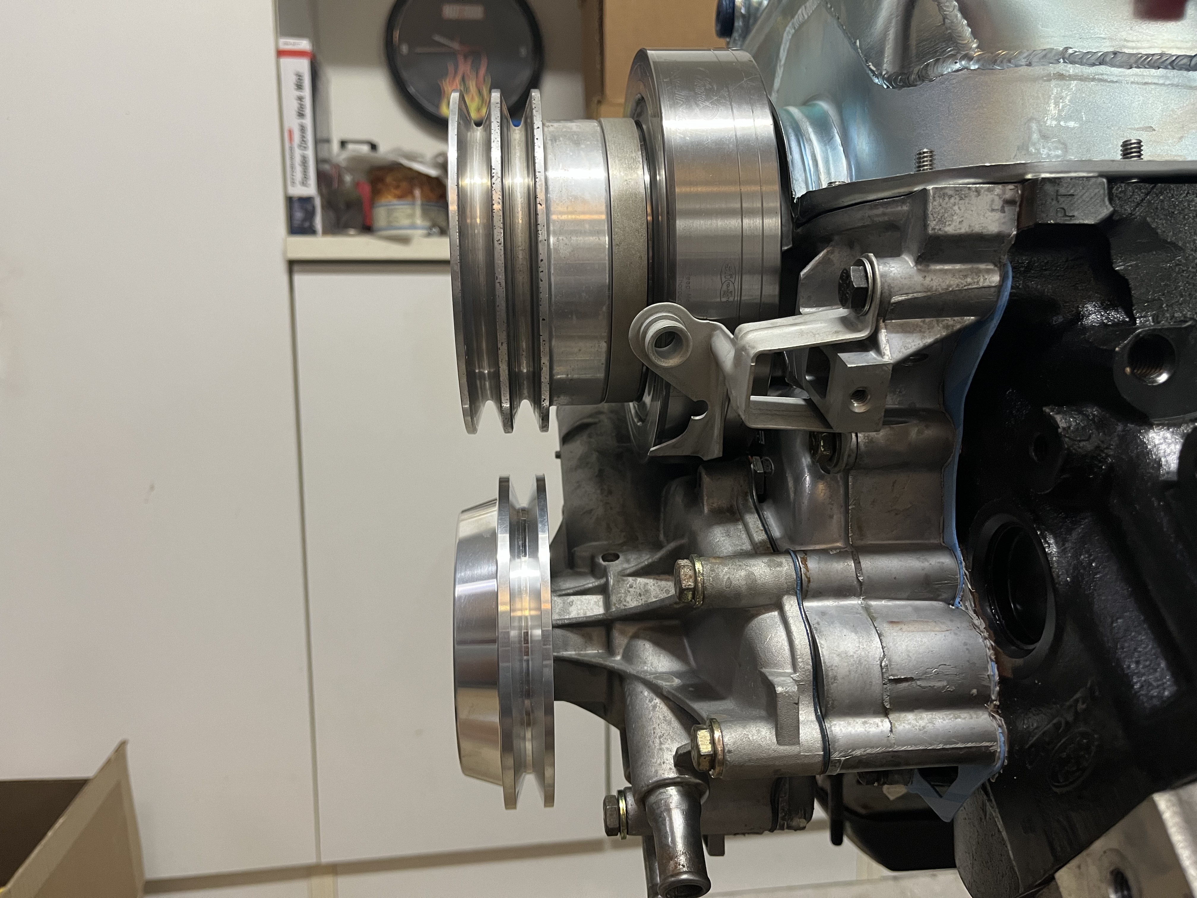

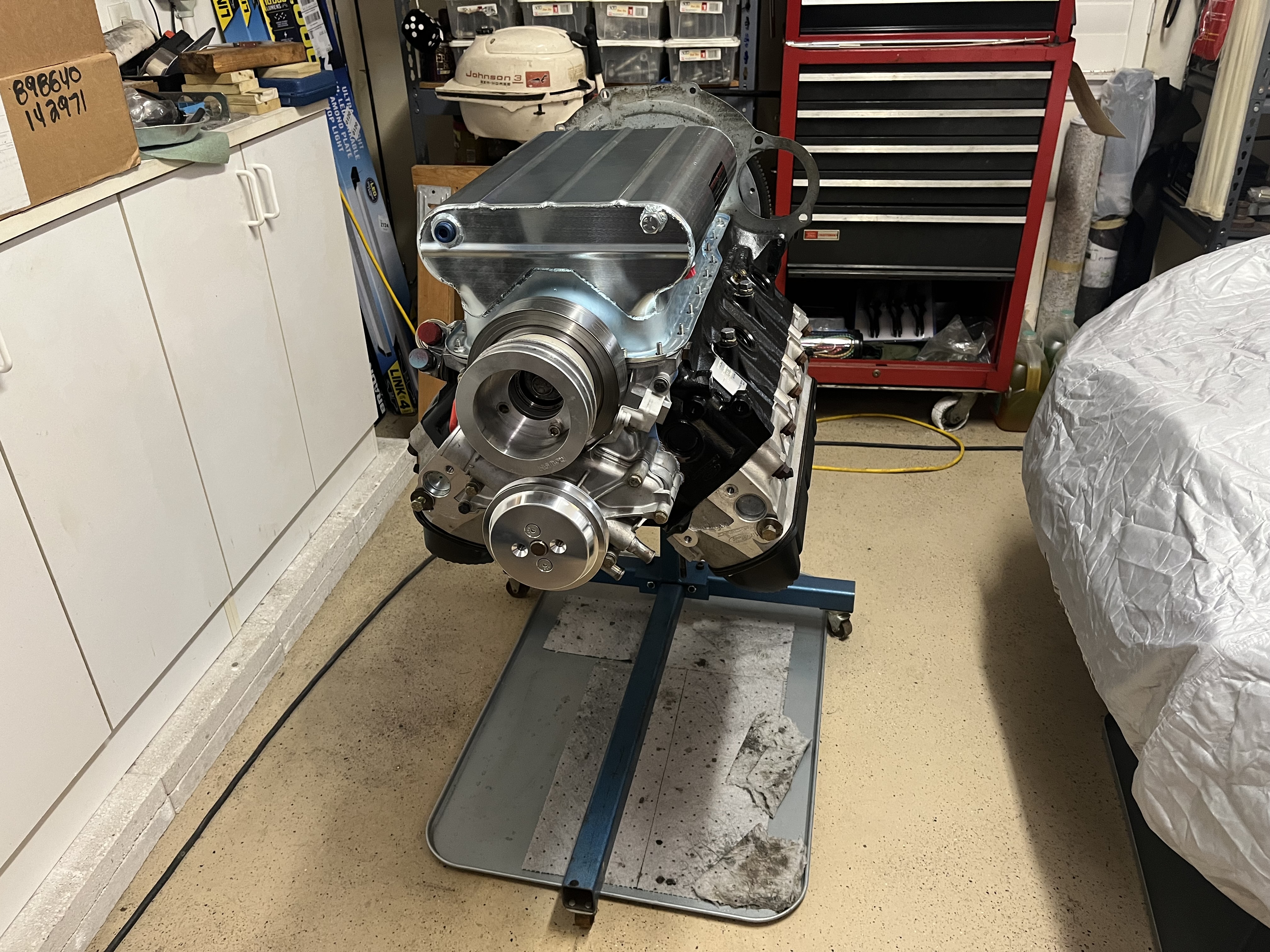

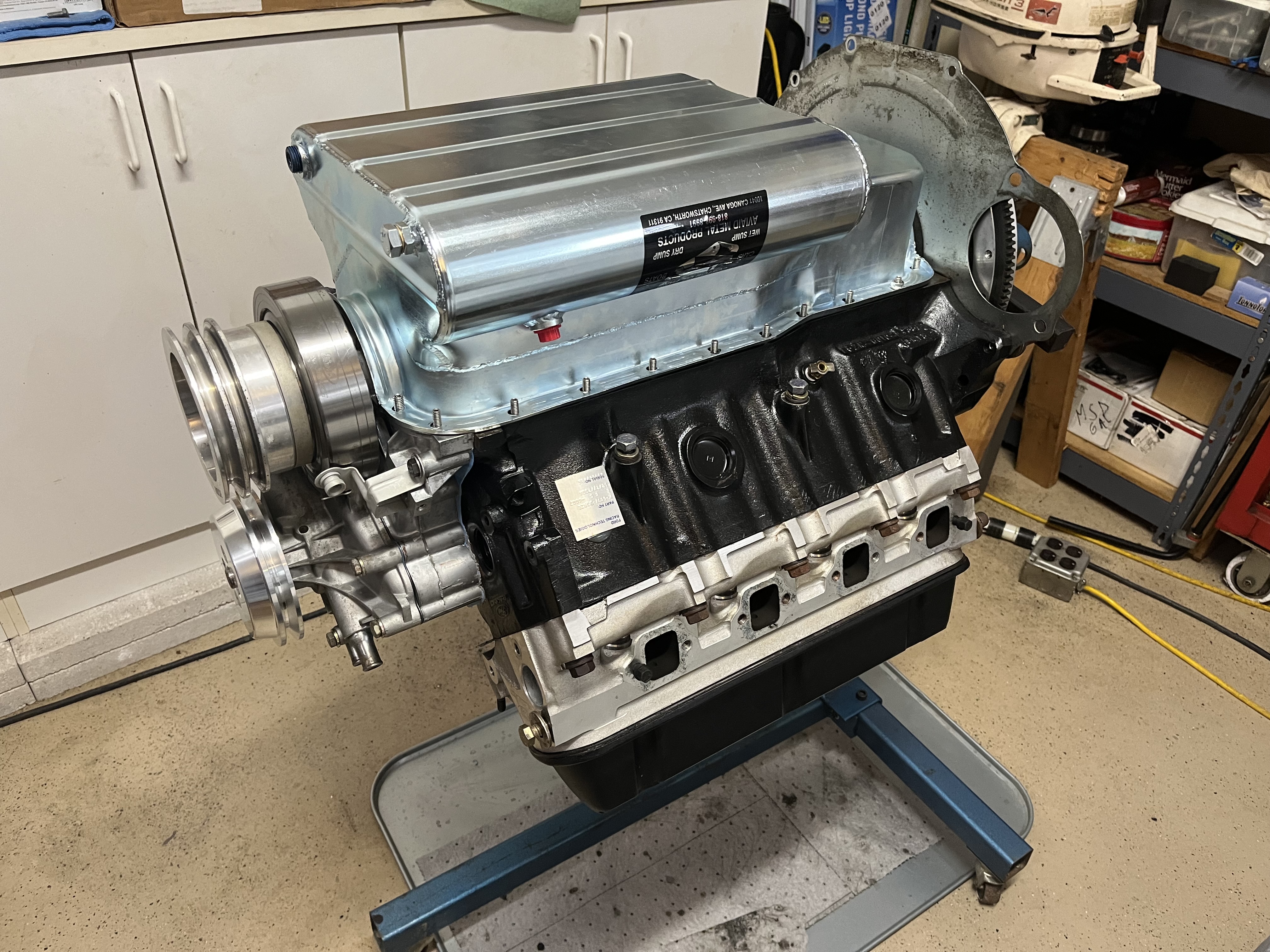

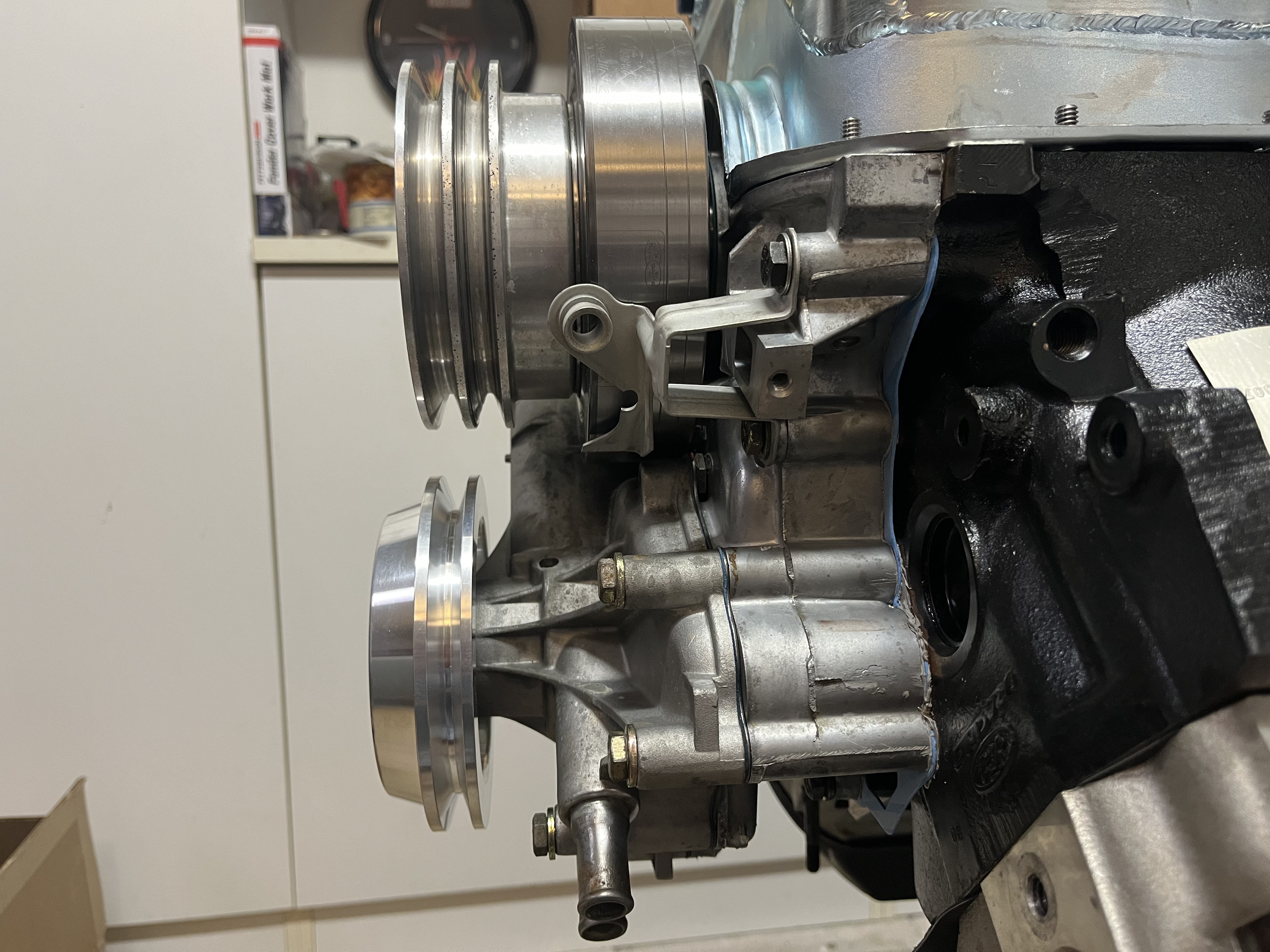

Making slow progress. Timing cover and balancer are installed, still waiting on the water pump gasket. New CVF WP pulley doesn’t quite align with the Roush crank pulley and 1/2” spacer, looks to be off by about 1/8”, so I ordered a 5/8” spacer from CVF, which should put them nicely in alignment…fingers crossed.

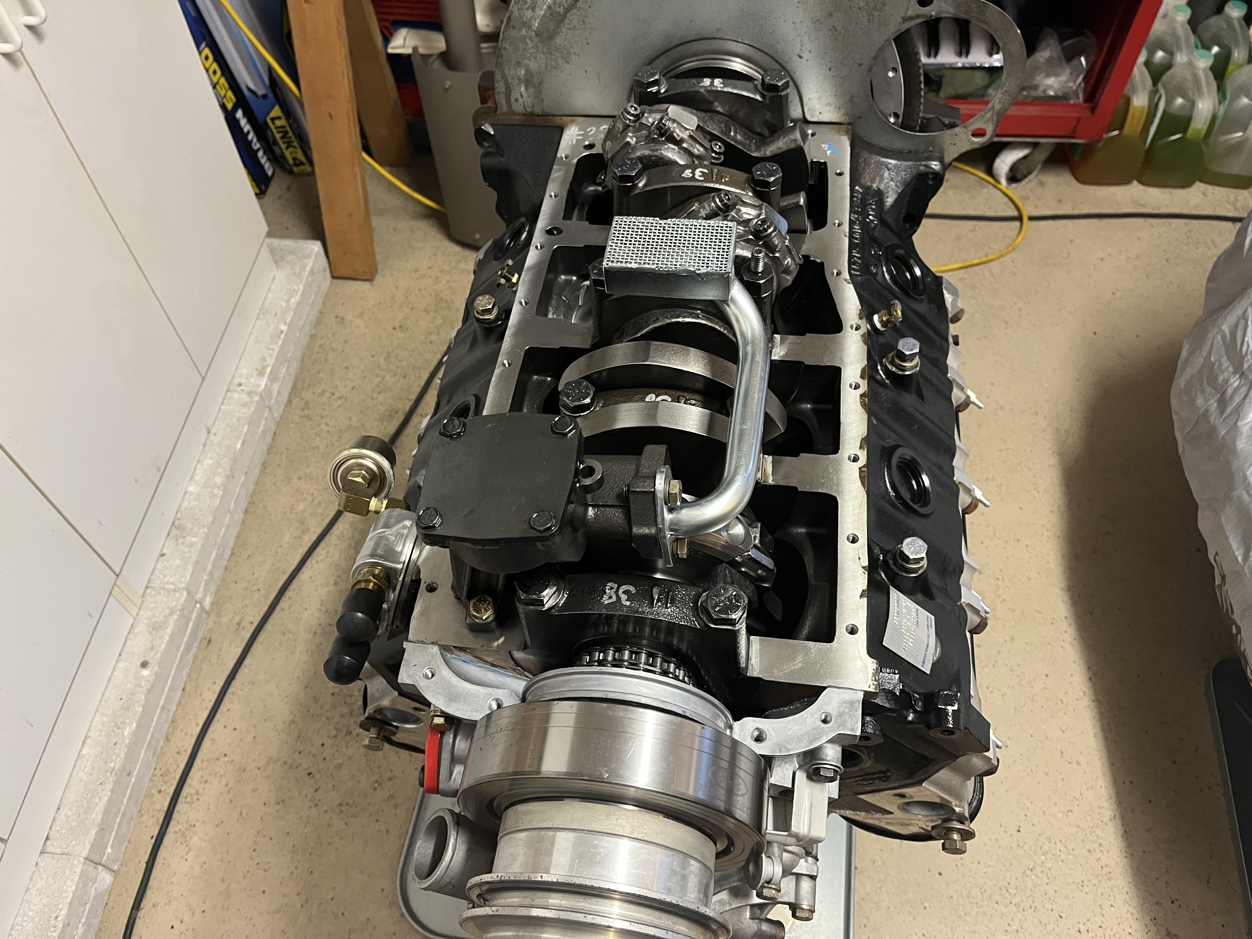

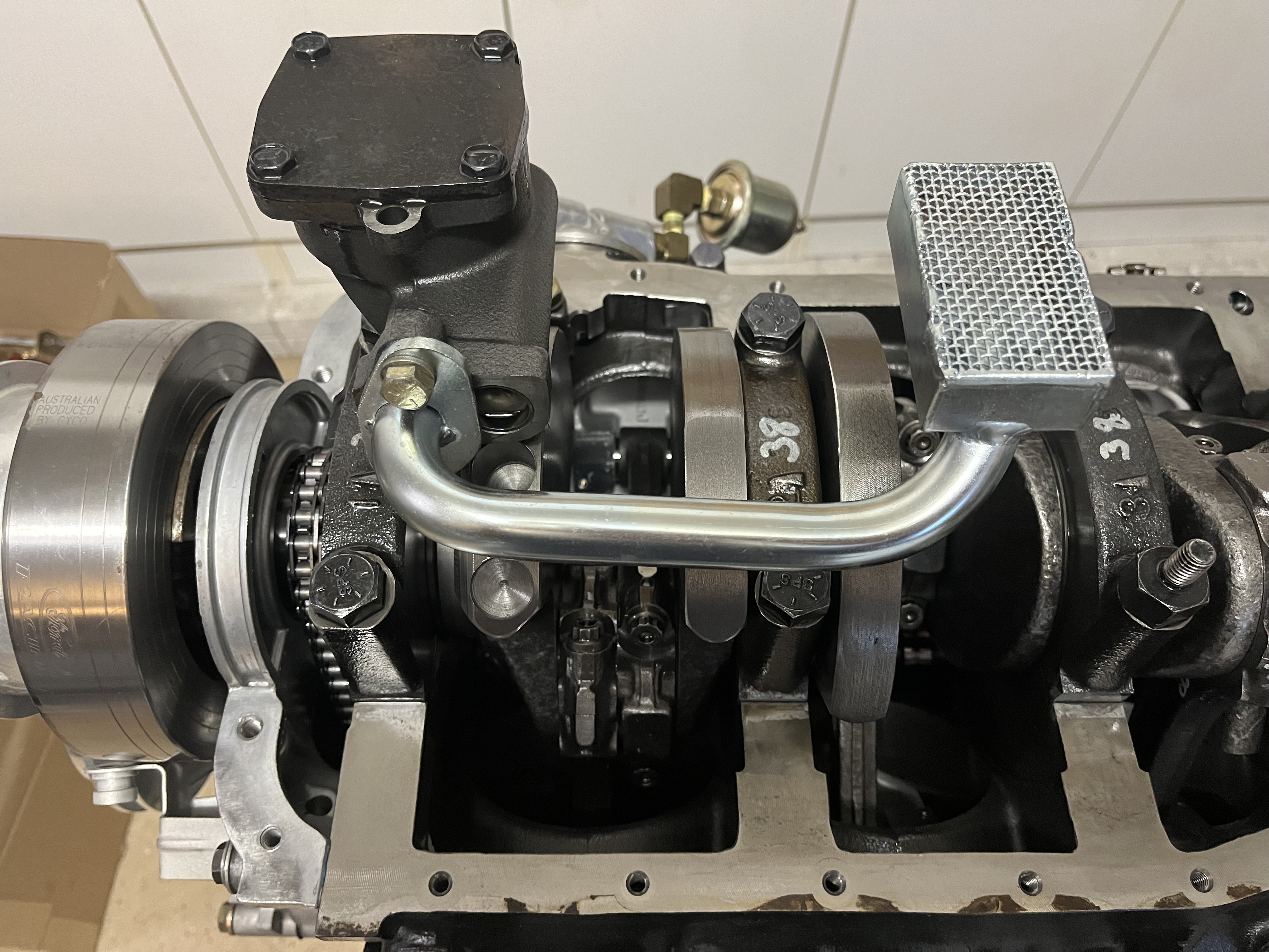

Flipped the motor over to start fitting the new pan. Had to elongate some holes to clear the studs and had to provide some “gentle persuasion” to get the flanges to sit somewhat flat. But as Tom likes to say, “bolts right in.”

Out of curiosity, I removed the 1/2” spacer, and the front groove of the crank pulley actually aligns perfectly with the WP pulley, which now gives me some new options to look at…

Another work of art in progress! The cleanliness seems to be fantastic.
A small thought: if you're going to add an oil temp gauge, this might be a good time to install the sensor?
PS: Does the GT40 forum mention anything about pulleys? That photo looks like you've nailed it, unless there's something later on that won't clear or fit...
Thx Tom, I do like a clean motor…
I already have oil temp and pressure senders located at the remote filter takeoff port.
Surprisingly, almost nothing on the forum covering pulleys and alignment.
Yeah, without the spacer, alignment is “balls on dead accurate,” it would give me a little more room in front if I can get the AC to align with the rear groove.
Lookin good. Those look like some big main cap bolts.. Seem to be a larger bolt than the Chevy.

Thx Ken. Yeah, the cap bolts are definitely more hefty than what I was expecting, probably a benefit of the Sportsman block. I’m pretty impressed with the motor overall, it should serve well in the GT.

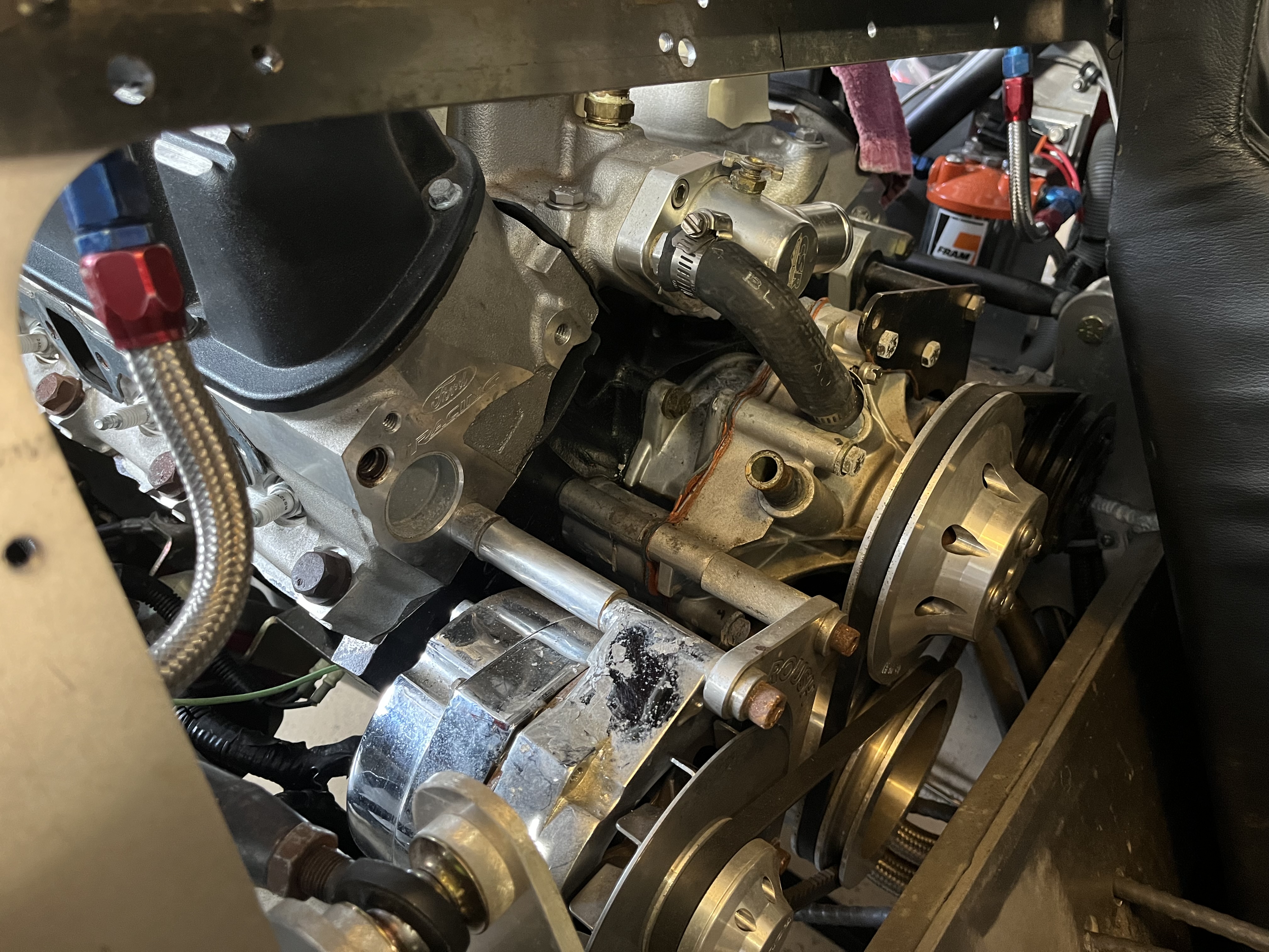

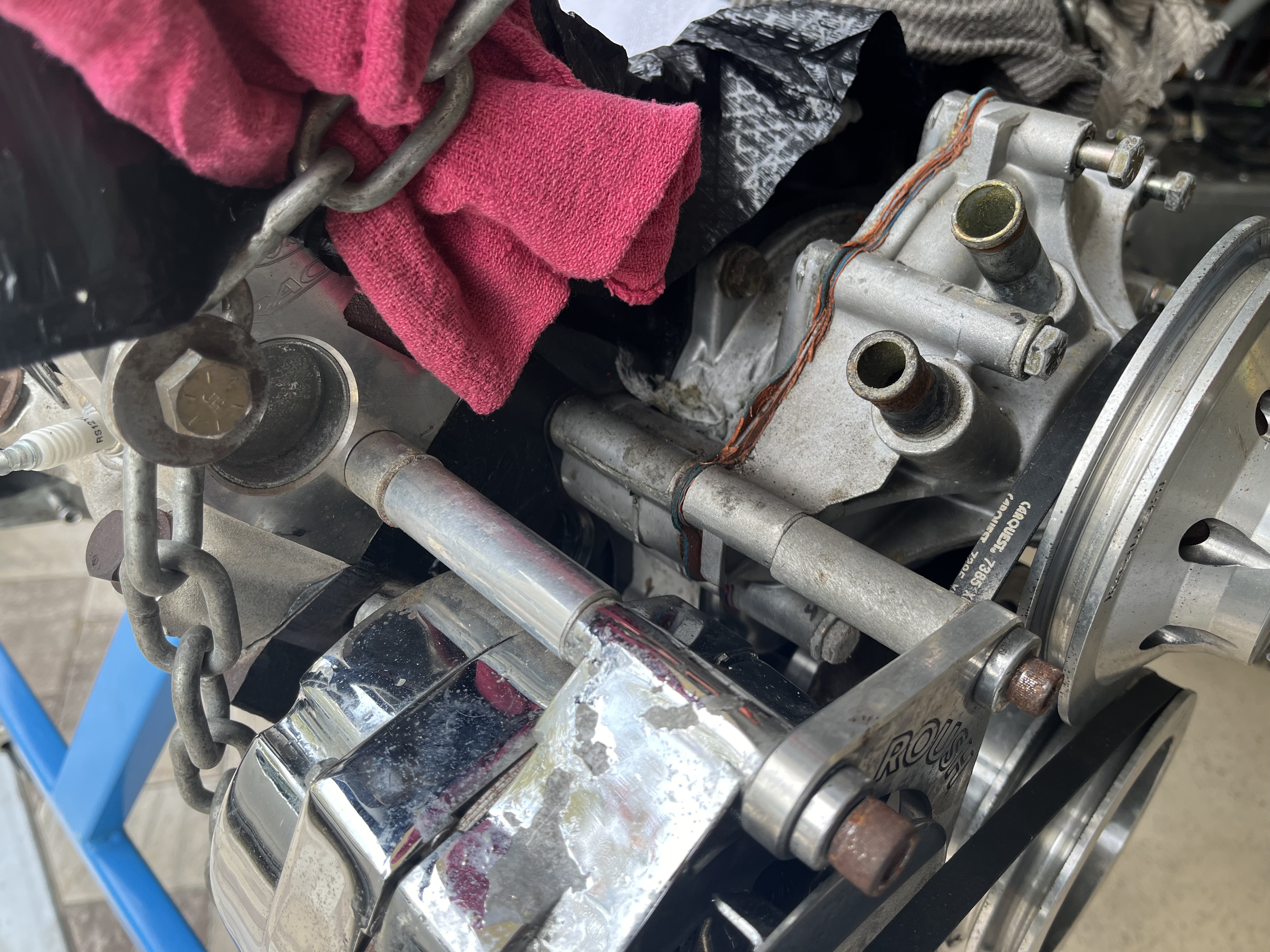

This is pretty much what can be seen of the damper and the timing marks…
I’d have to relocate the alternator with different mount brackets, and still not sure it would be much of an improvement because the hash marks are difficult to read even without being blocked by the alternator and brackets.
