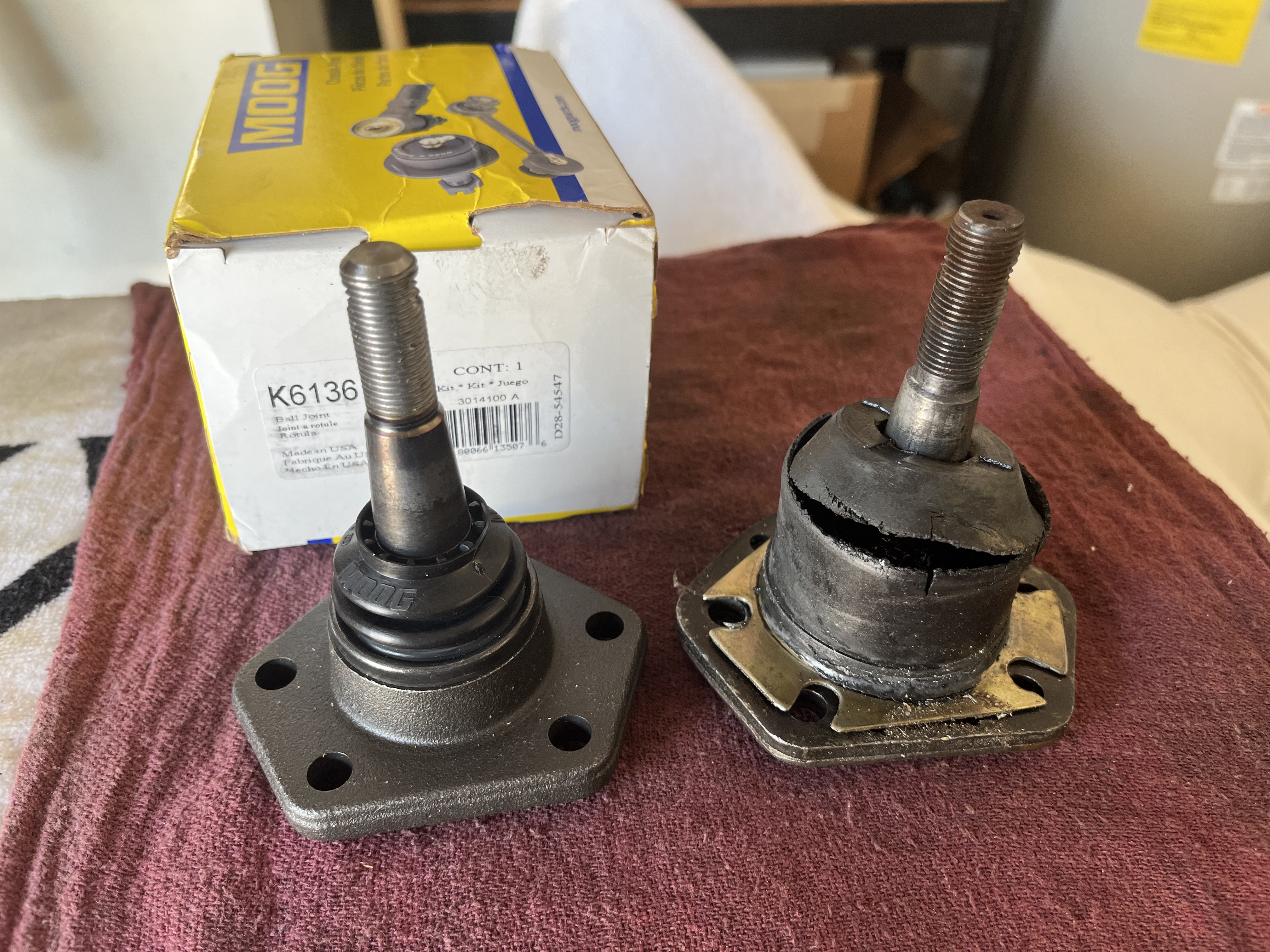

Received the new Moog LbJ today and got to work removing the old one…well, old in the sense that it’s been on the car a lot of years, but certainly not worn out other than the two piece grease boot. :roll:
I had to modify the bj remover some more to fit the lbj. The lower joint popped loose easier than the uppers, which was a relief. The new joint was poorly packaged and the threads needed some Swiss file attention, but the newer designed accordion style boot looked and fit well. Rechecked camber after install and still shows -1.25 degrees! :dance:

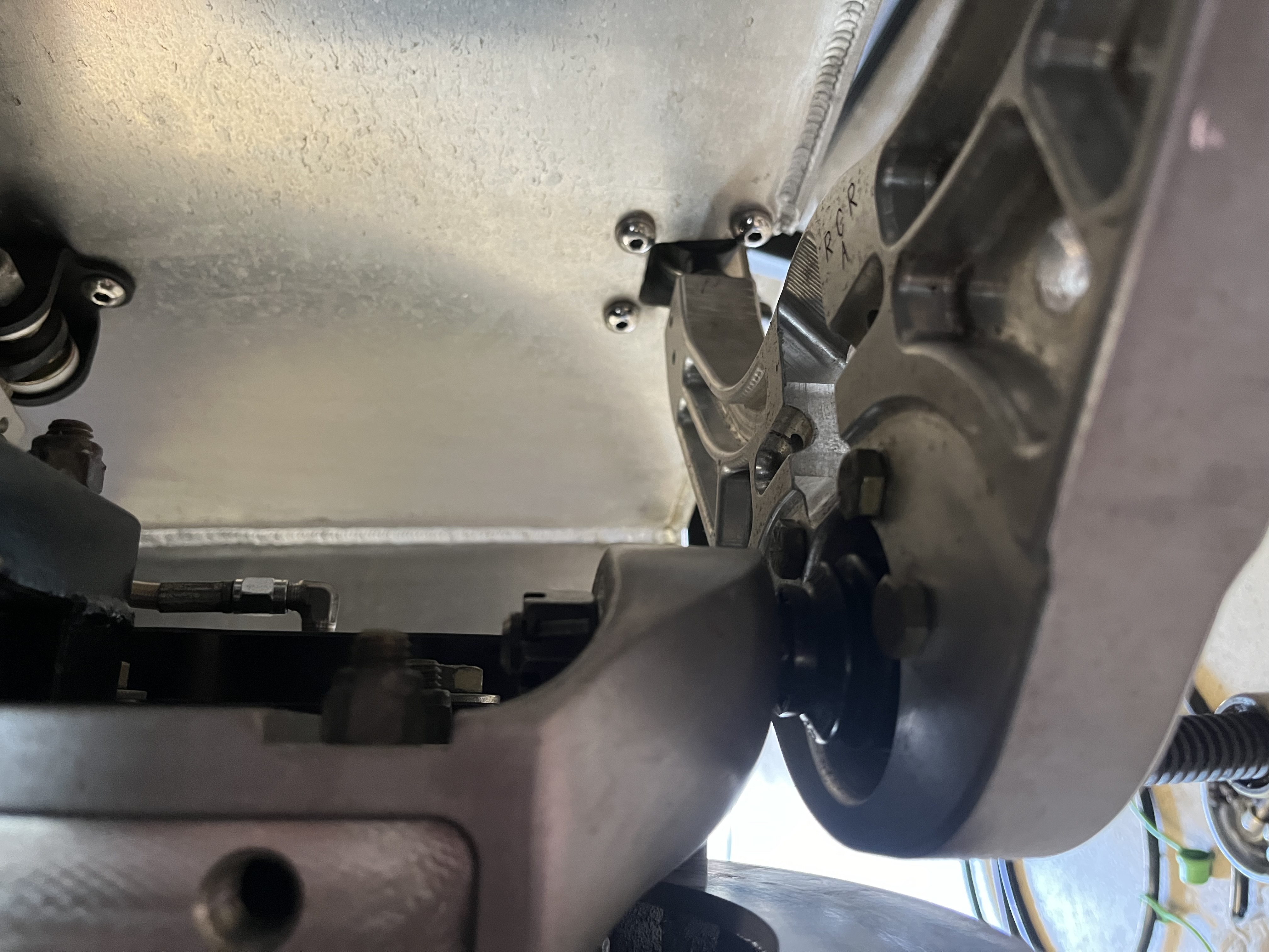

I’ve also noticed the driver side front brake caliper has a bit of a loose wiggle to it. I’ll have to look into that as well.

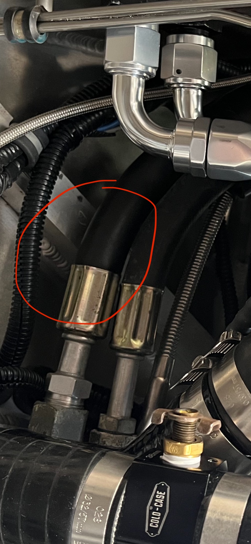

While I was under there, I spotted a refrigerant leakage source in the AC system. It’s a swaged collar on a short section of fabricated hose, connecting one of the two long hoses inside the center tunnel, to the compressor. Unfortunately, I’ll have to evacuate the system, remove the hose, have a new one made, replace the receiver/dryer, and then recharge the system…😏
Yep...A/C work is almost always a pain, and uncertainty that it really took.
Wishing you luck.

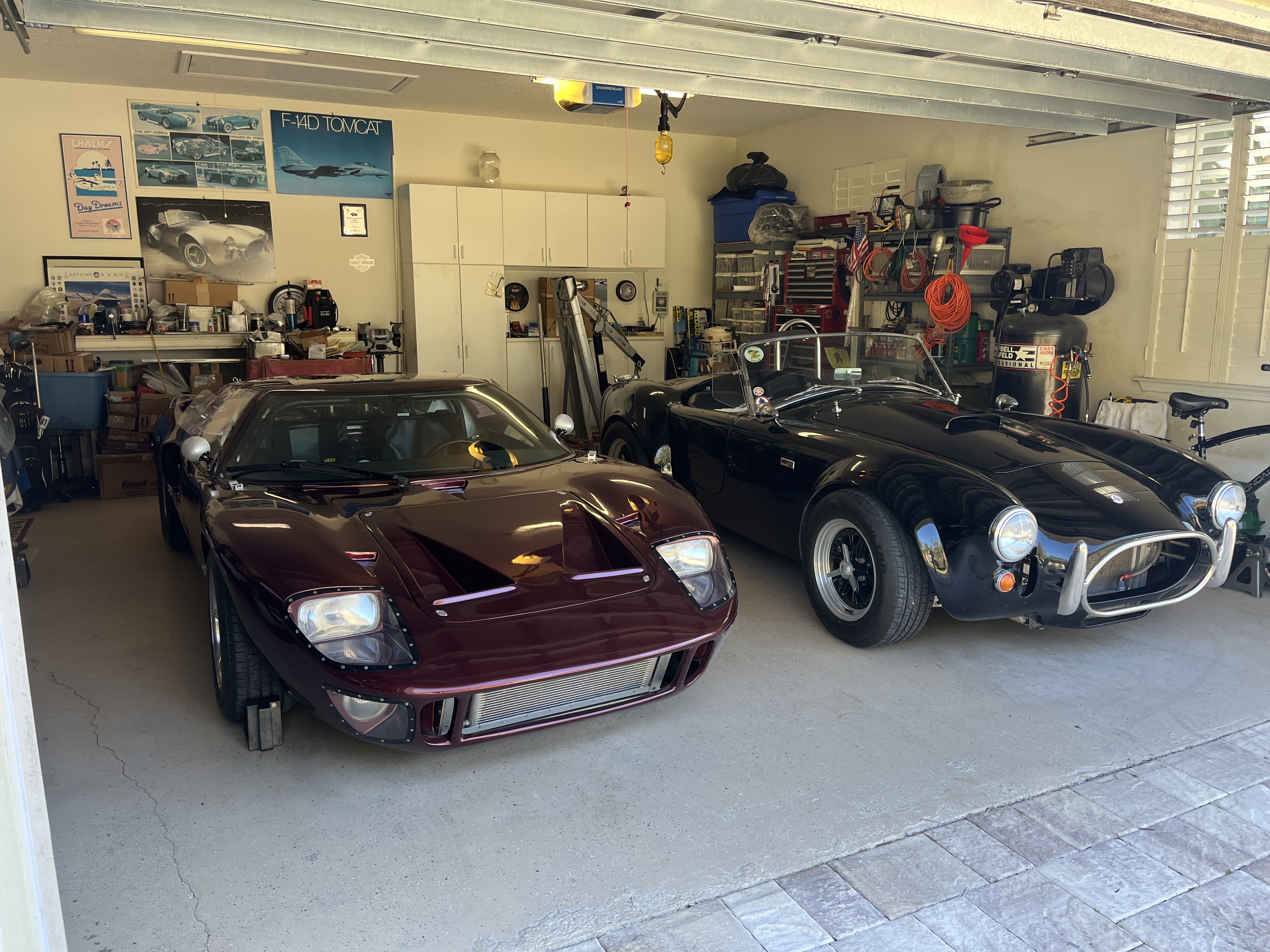

Backed it into the garage for the first time, which will make it easier to take out, not so much jockeying of vehicles required vs nosing it in. Backing up is always a challenge in this thing, rearward visibility is almost non-existent. Backup camera helps immensely, but I still don’t have a good feel for the car’s perimeter. The cobra is much easier to maneuver by far… :wink:

Darn good looking garage there Mike...Good job.
