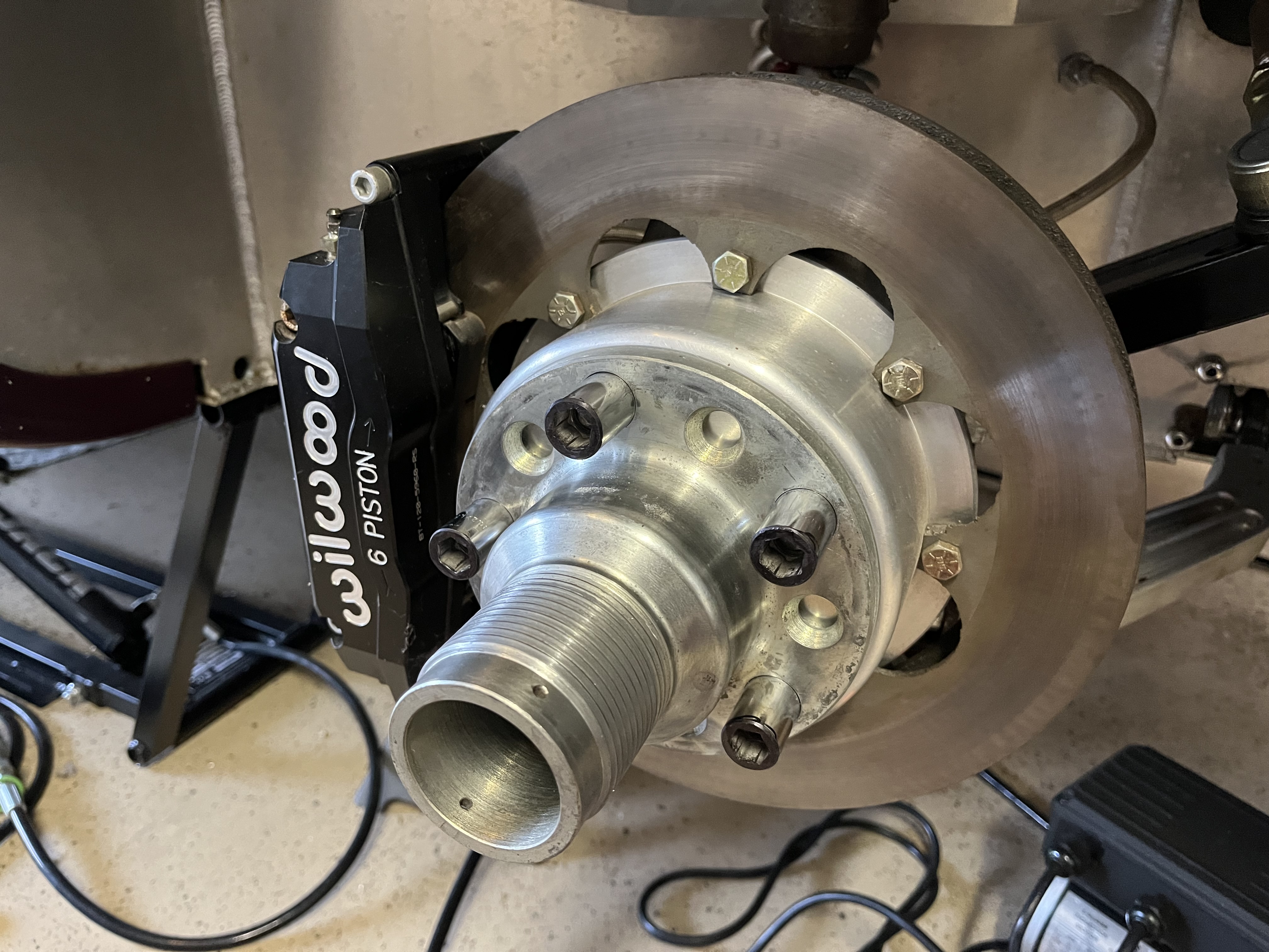

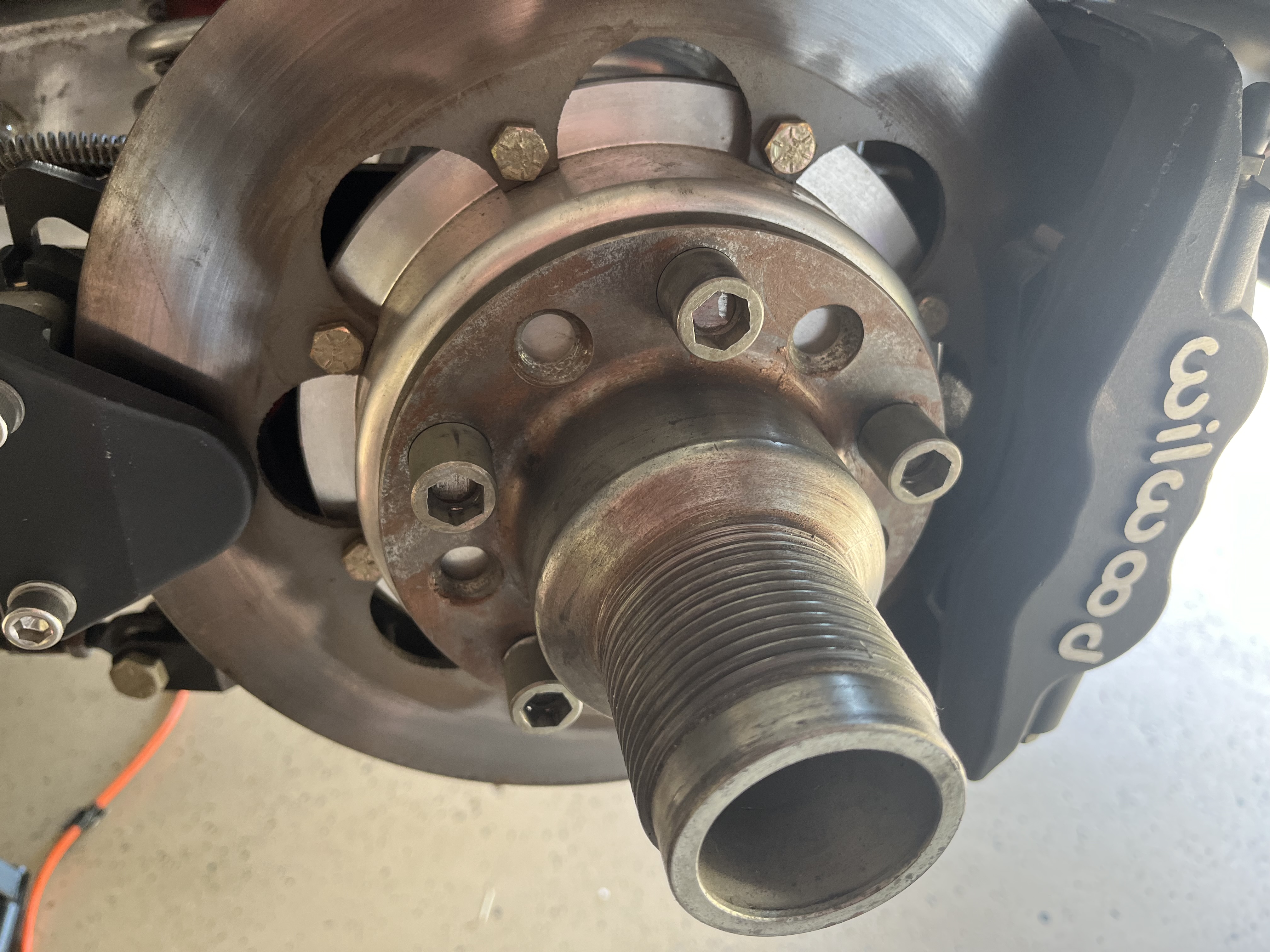

3) I think it’s a combined effort, both hub and pins center the wheel.

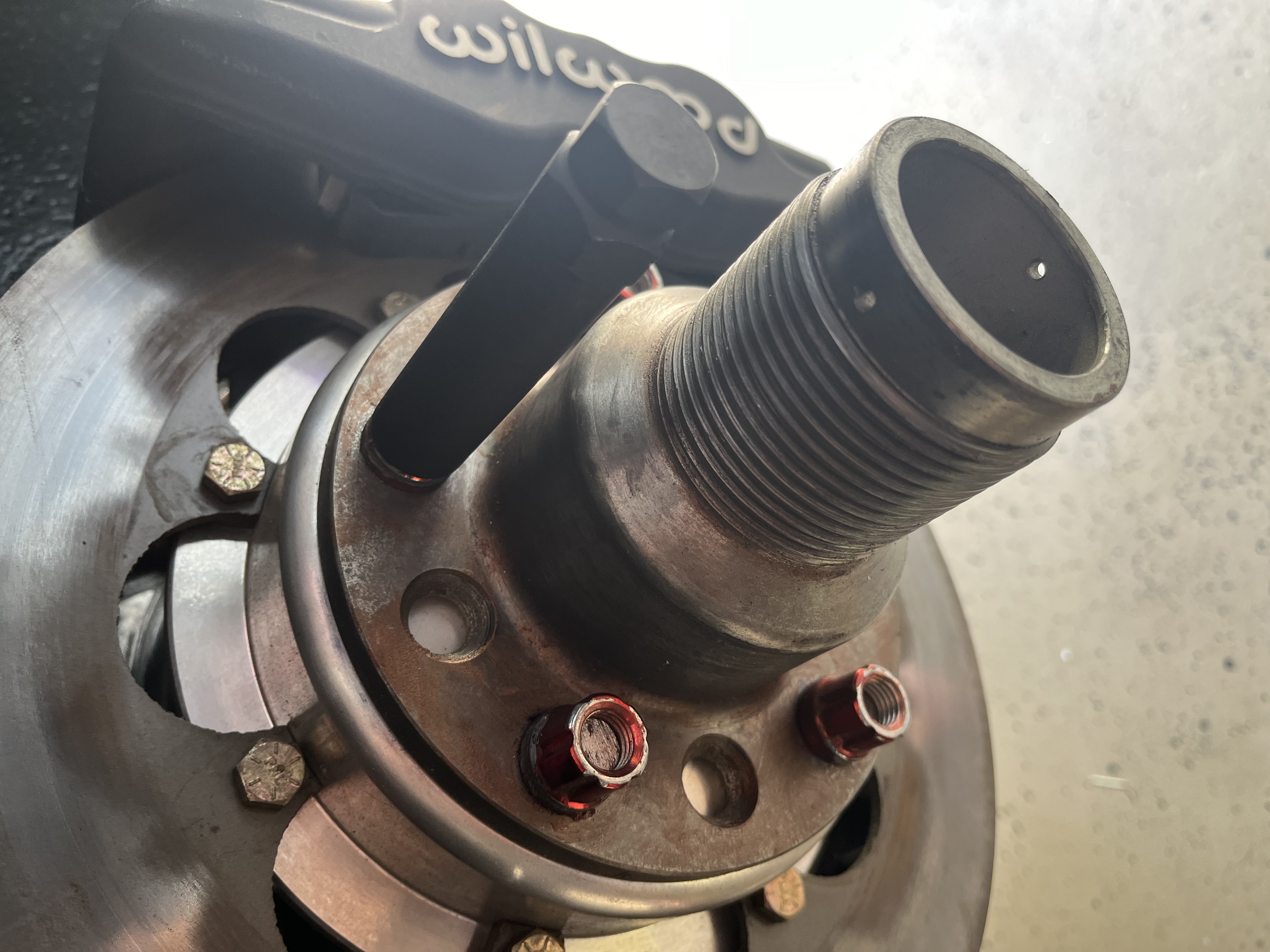

Upon further review (I may have watched too much football in my time), I’ve concluded that the red spline drive lugs are completely inappropriate for this application. Fortunately, I had a correct set of pin drive lugs in the tub of parts I received with the car.
No idea why they were replaced with the red ones, but I’ve set about to make things right. I had to buy a spline drive socket to remove the red lugs, which William and O’Reilly’s helped me out with. I also needed a 12mm hex socket to torque the pin drive lugs on with, once again Will and O’Reilly’s got the assist.
The left rear wheel (problem wheel) slipped right on and sits flush to the hub now as it should! I replaced all of the red lugs on both rear wheels, so they’re done. The front wheels I’ll get to next, but one of the pin drive lugs is missing from the set, so I’ll need to source another one before I can
finalize the project.
Vintage Wheels sells them as a set for $100, I’m hoping I can persuade them to sell me a single lug, or maybe a few as spares…
Oh well, one more box

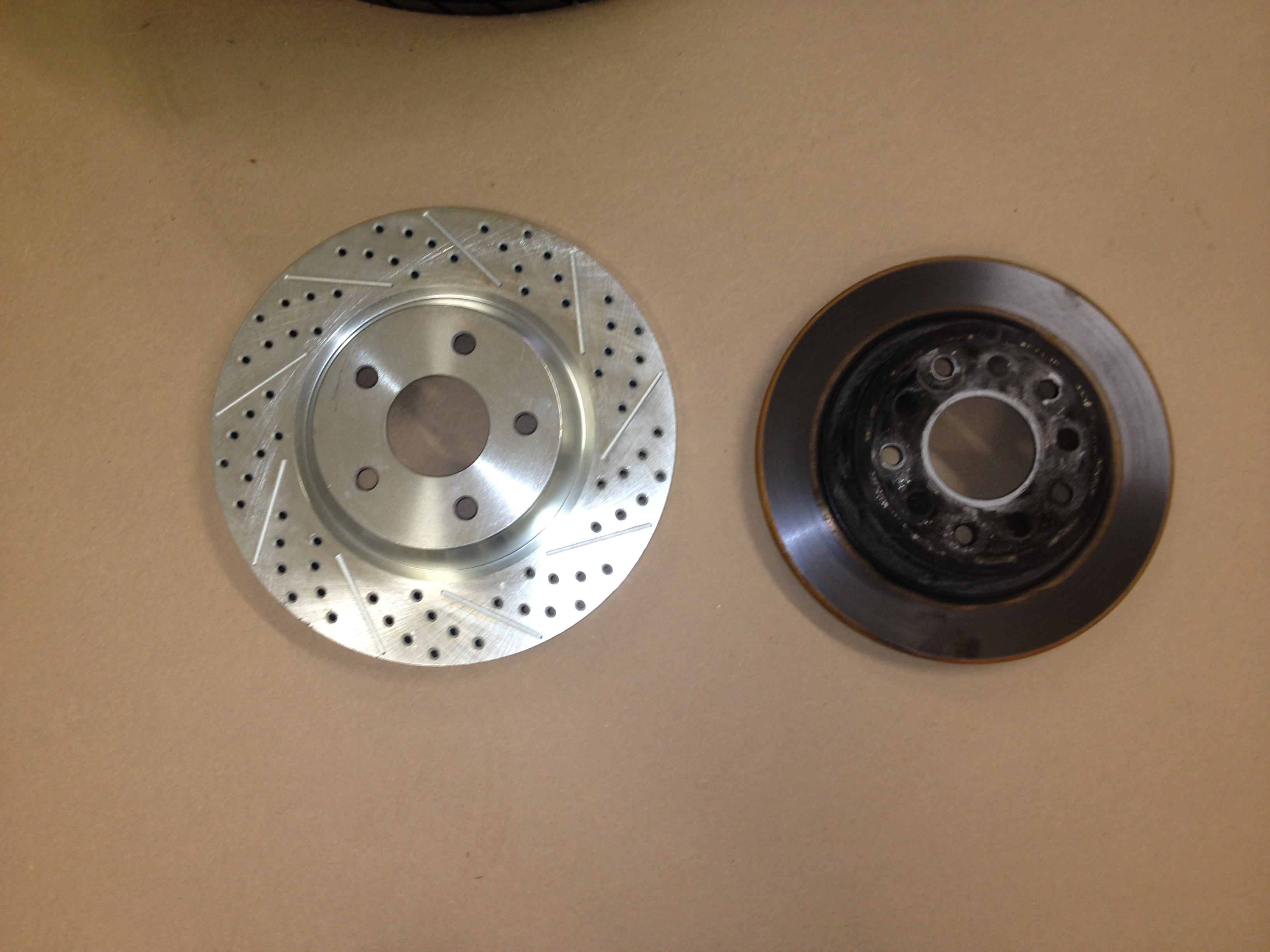

Hi Tom, I didn't want to start a new thread to show you how much larger my Baer brake upgrade 13" rotors are over stock.
So I hi-jacked Mikes....

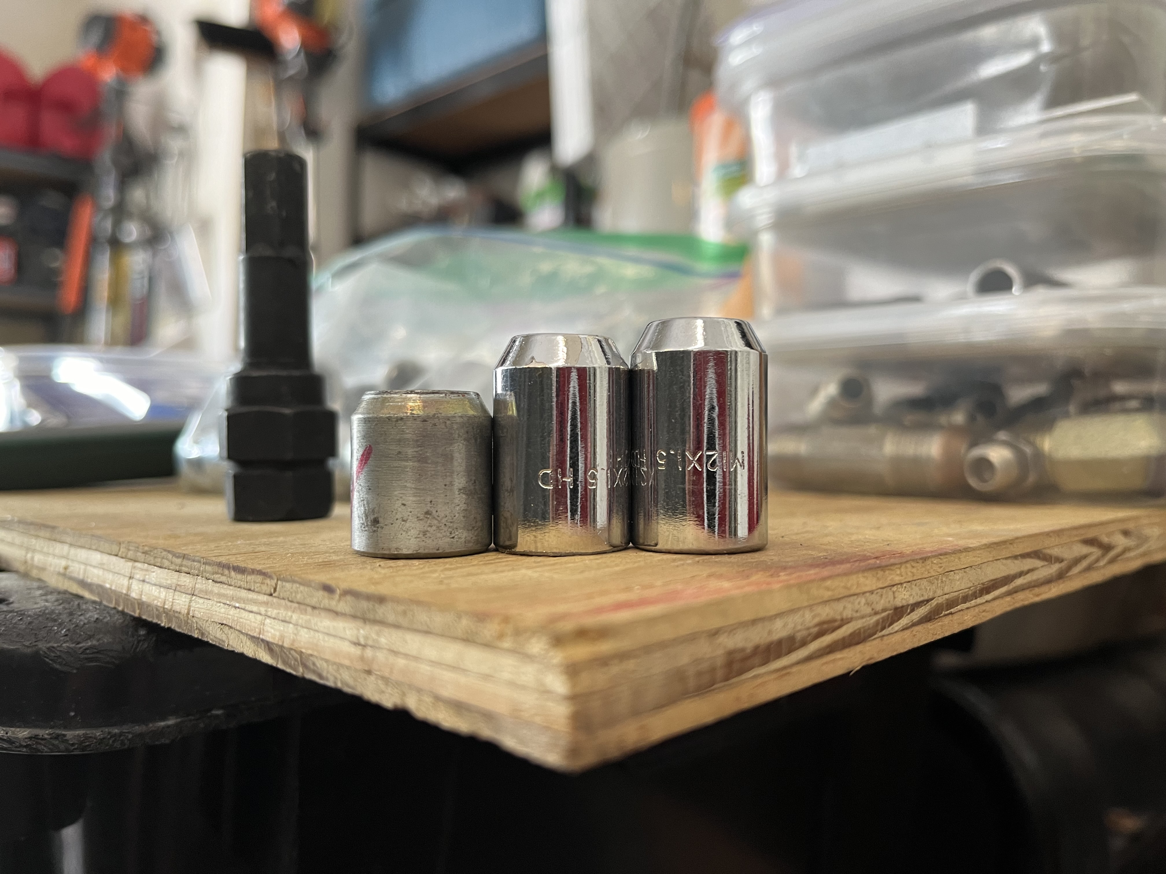

I bought a new set of forged pin drive lugs from Vintage, but they are bit long for my application. The holes in the wheels are 1” deep and the new lugs protrude about 1 1/8” once seated into the adapters. I spent some time today shortening five of the new lugs on the bench grinder.
One wheel done (front right).
