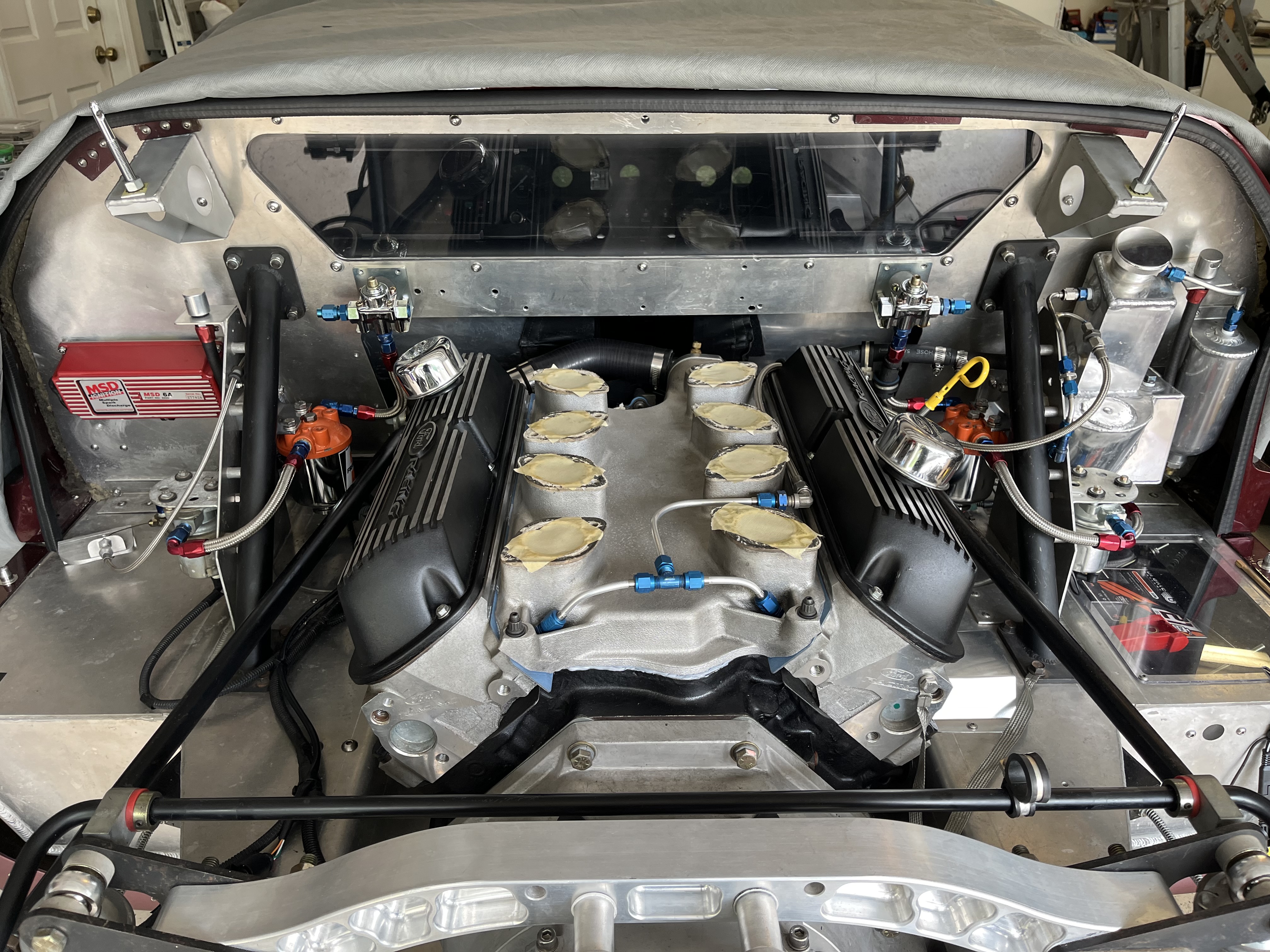

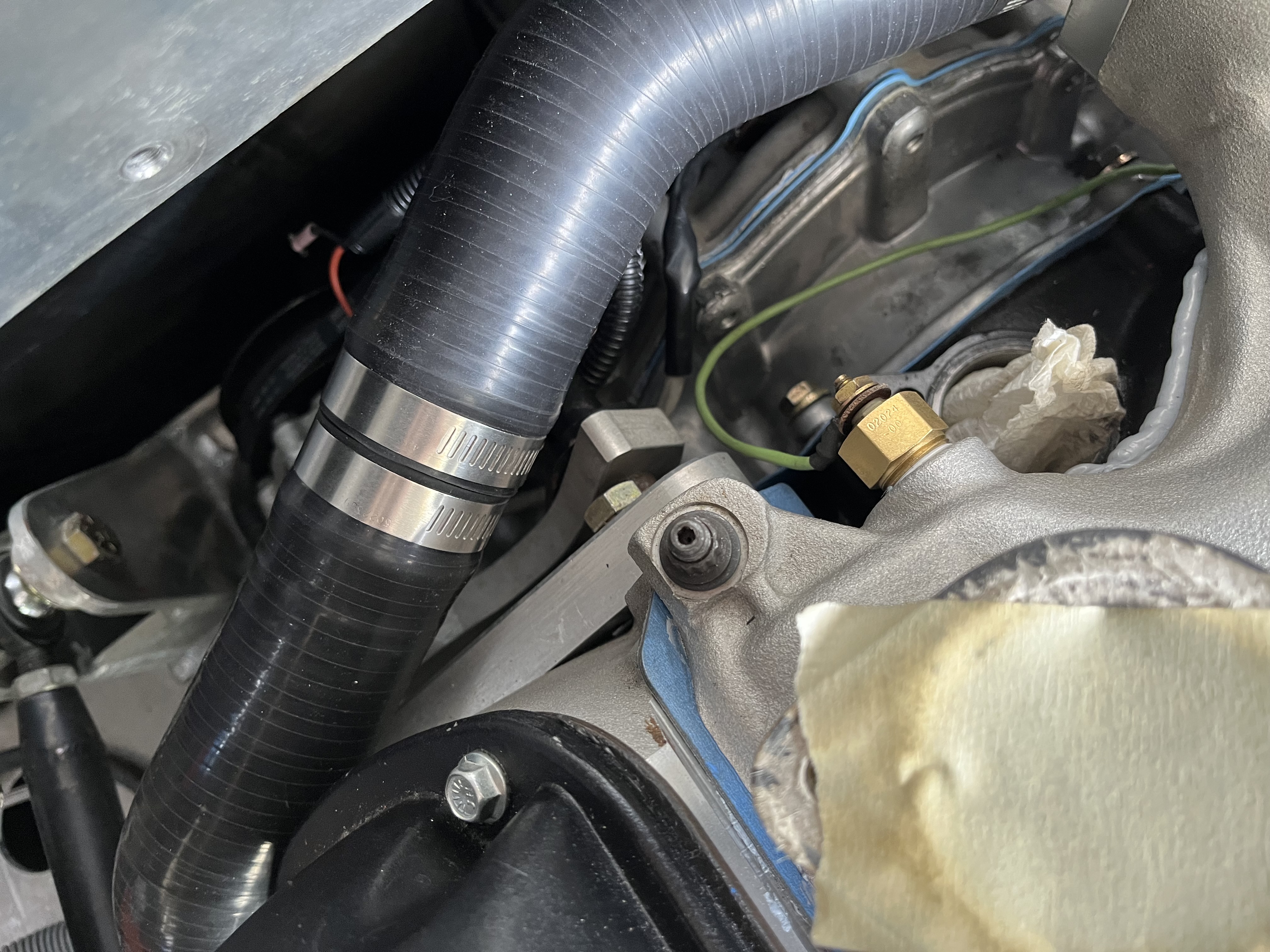

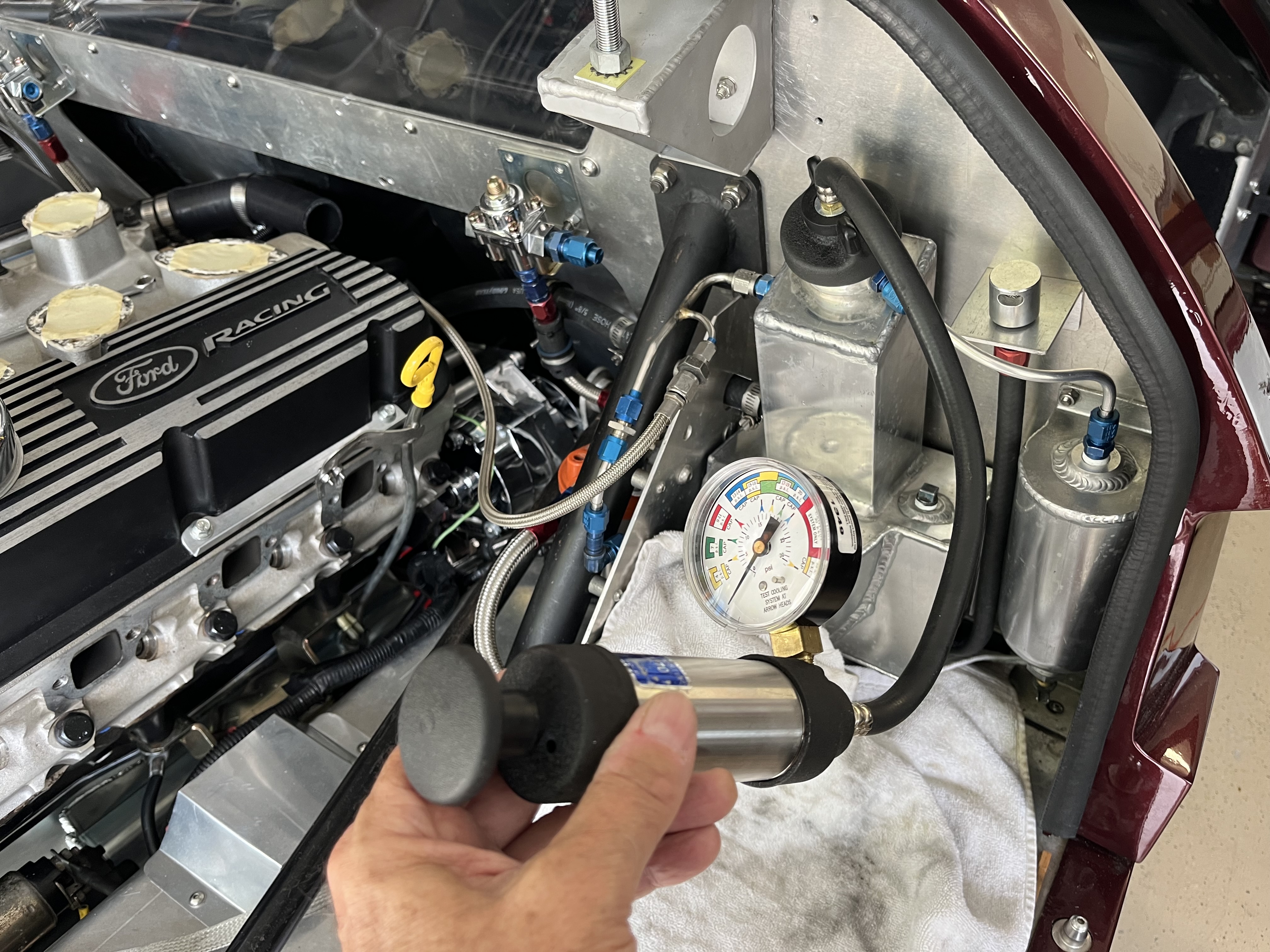

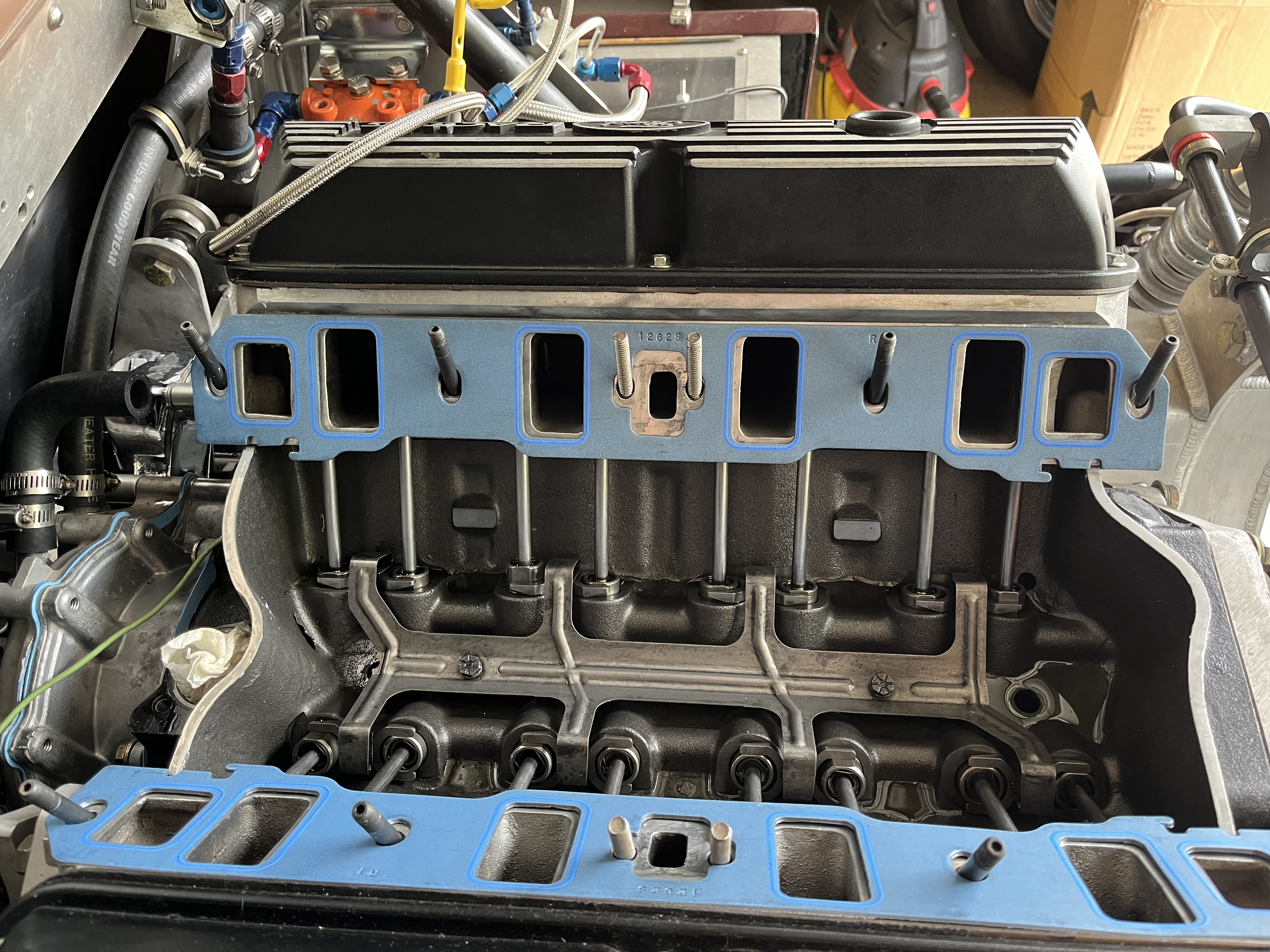

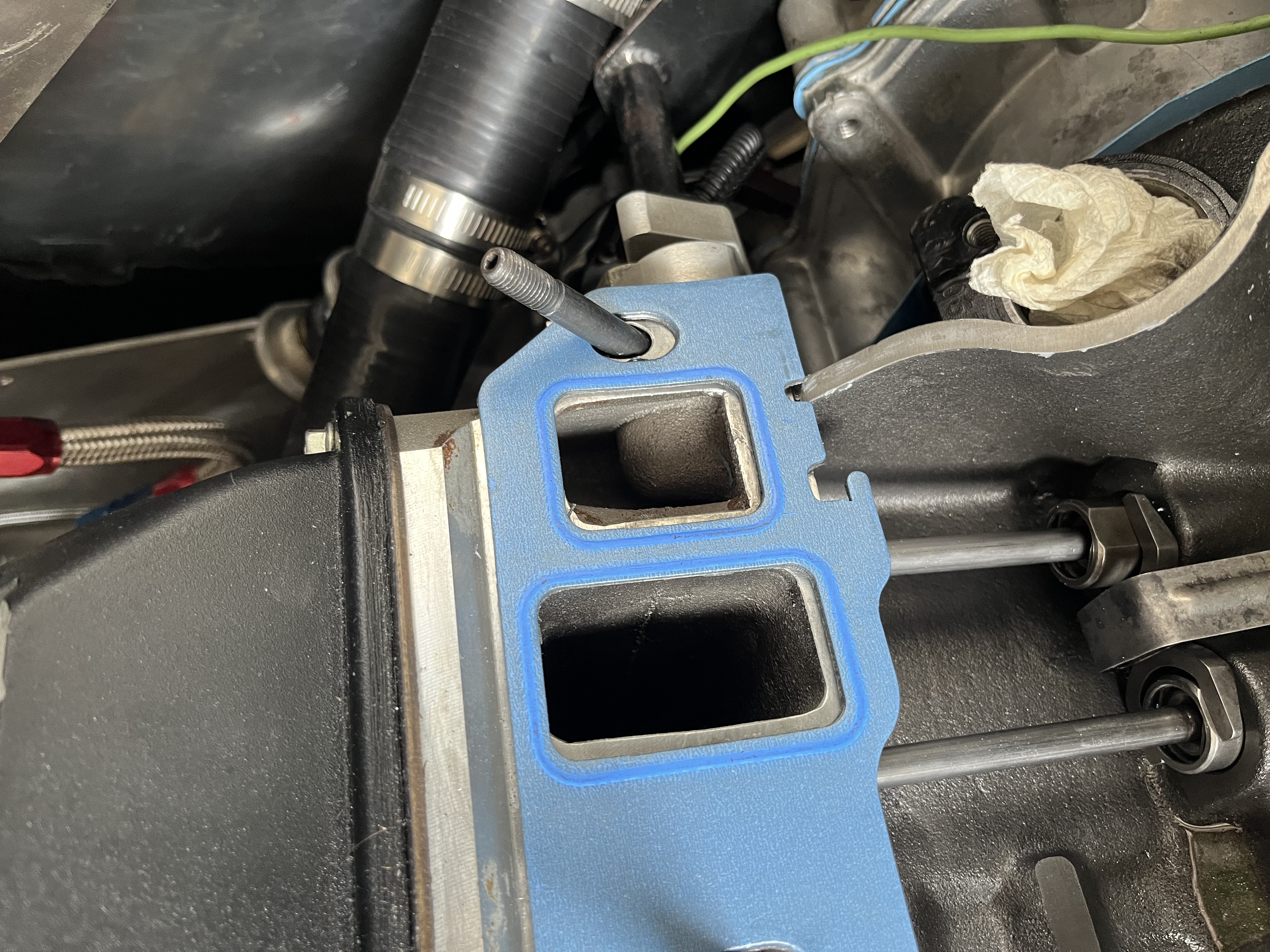

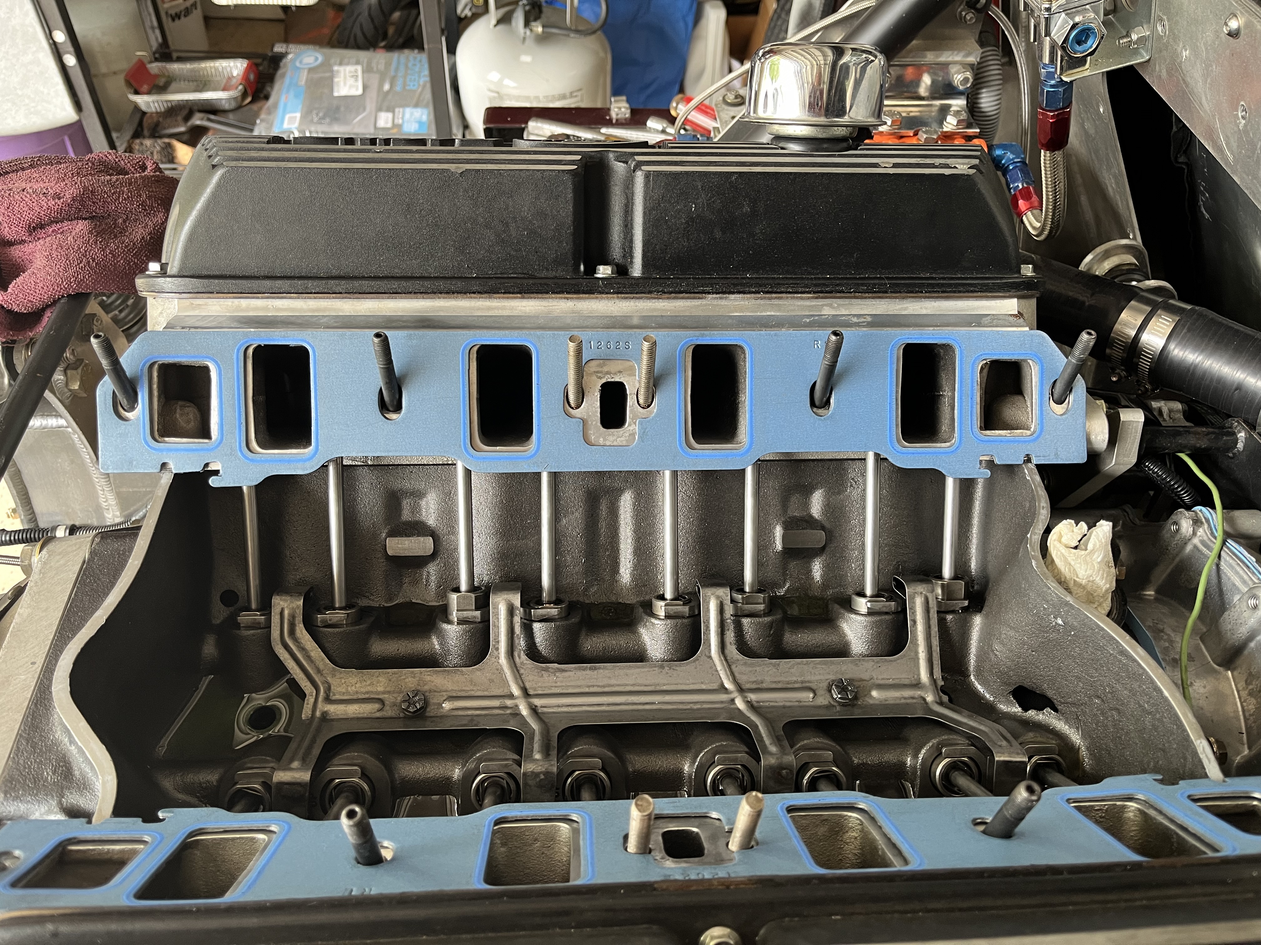

Okay, the mani is back in place. As expected, the water ports on the A50 gaskets are a much better fit and should definitely seal this time. I’ll let the sealant cure over night and try pressure testing again tomorrow.

When I saw your picture of the new M-9439-A50 gasket in place I had major deja vu
Those look just like the Fel-Pro Print-o-seal gaskets that we renamed to Fail-Prone Print-o-leak!
If they have steel reinforcement, they should be fine. If not I'd suggest you take it apart one more time and go with Victor Reinz or similar. The Fel-Pro part number changed by adding an "S" at the end to indicate the steel reinforcement.
I dimly recall you were aware (maybe helped?) when my Cobra had that problem.
Breath easy Tom, they are steel reinforced…

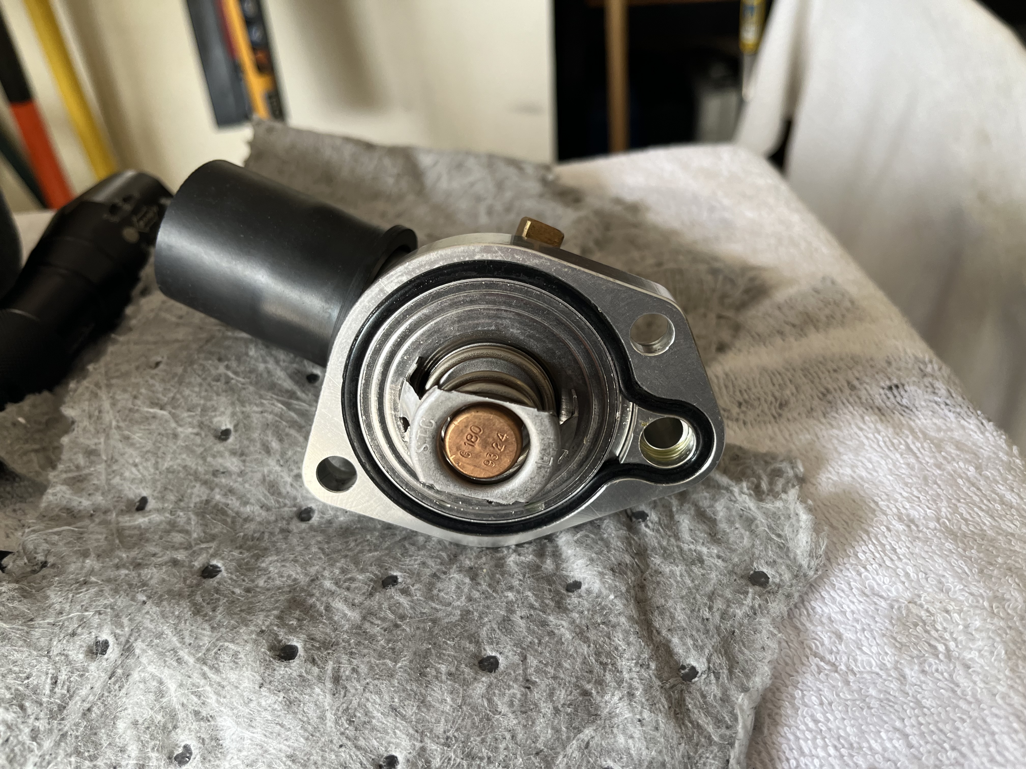

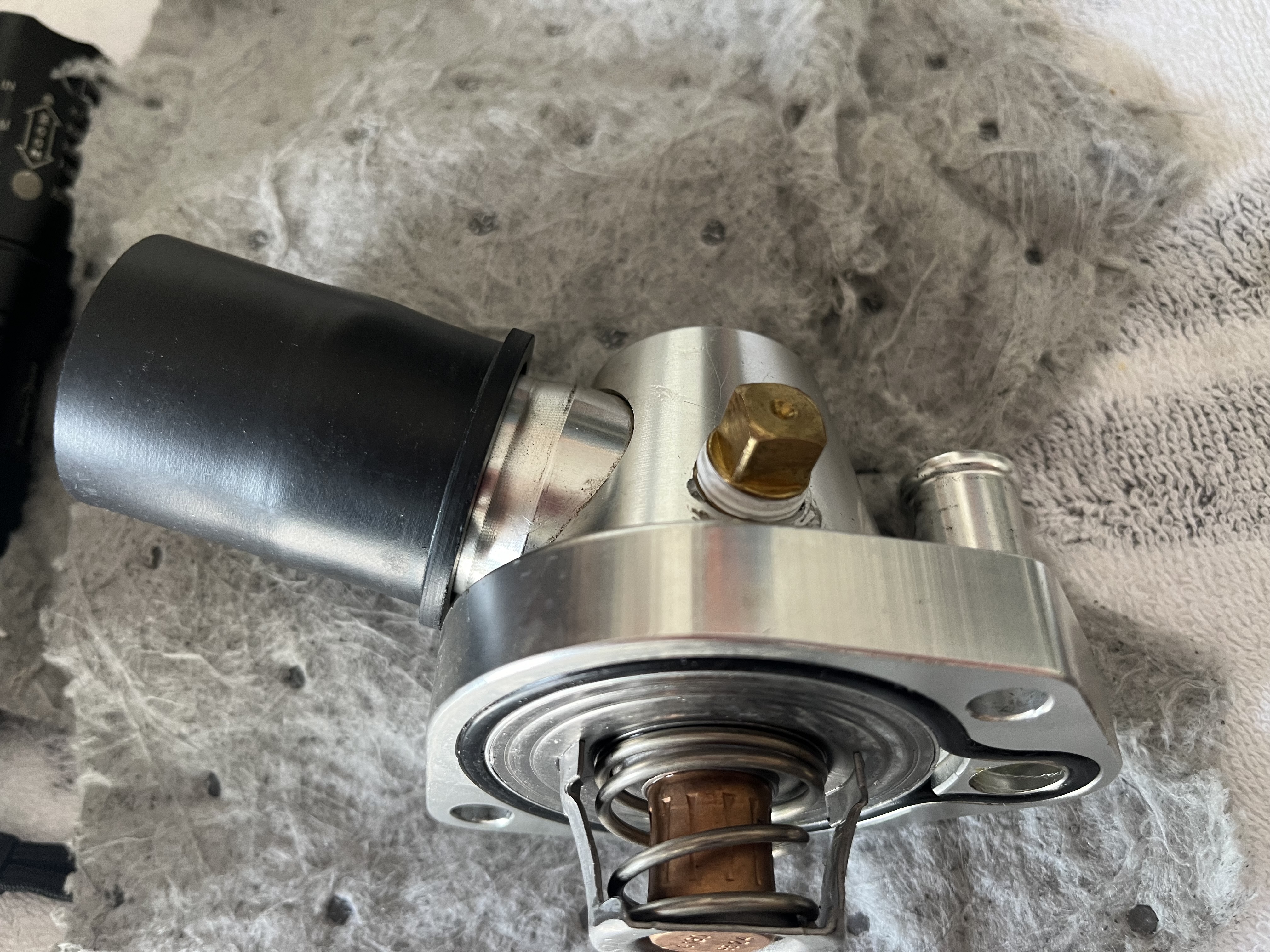

Mani gasket seems to be good to go, no obvious leaks under pressure, but now the CSR thermostat housing is giving me fits…
- IMG_1357.jpeg (3.04 MiB) Viewed 30186 times
- IMG_1356.jpeg (3.43 MiB) Viewed 30186 times
- IMG_1355.jpeg (3.45 MiB) Viewed 30186 times
