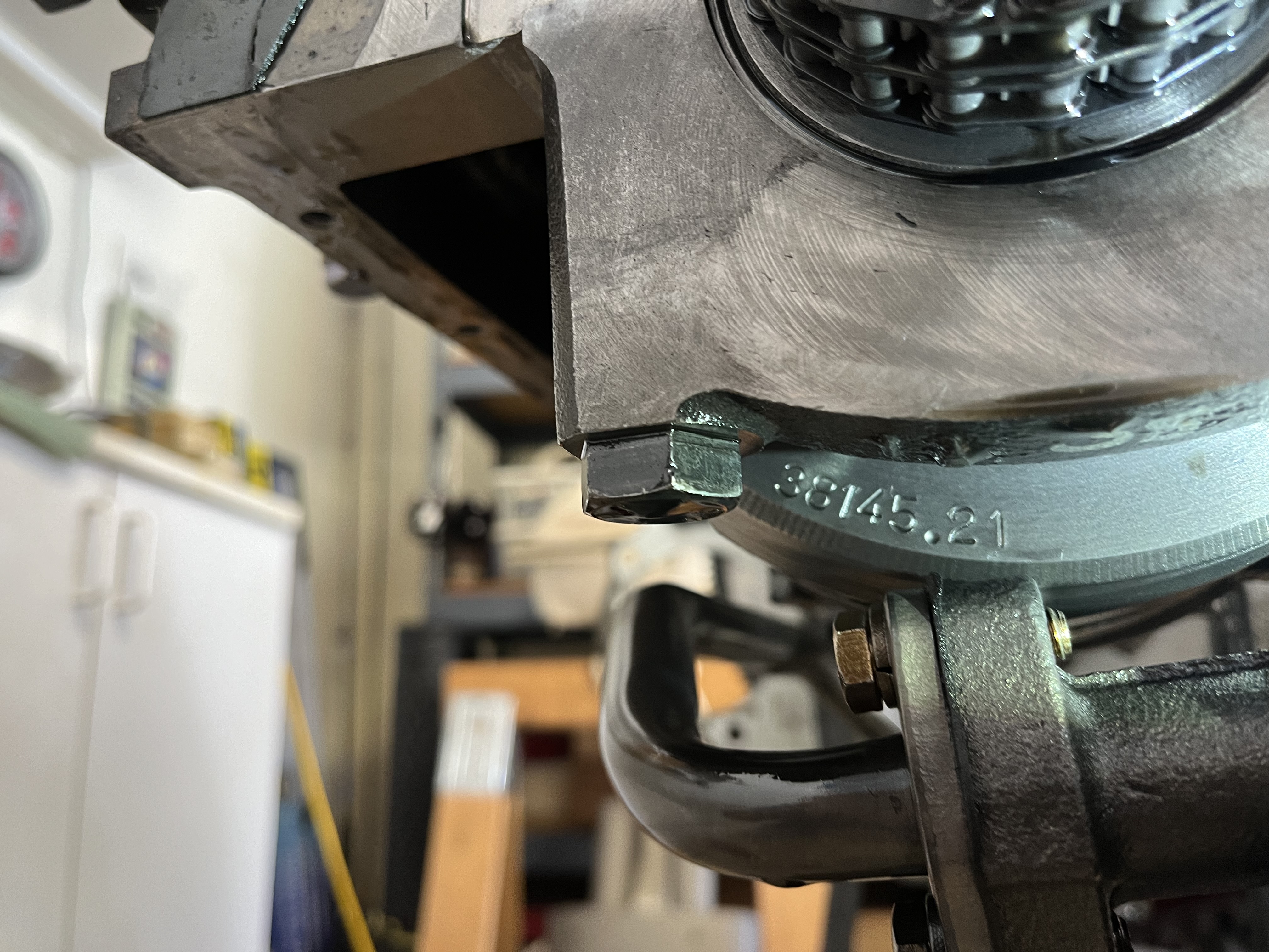

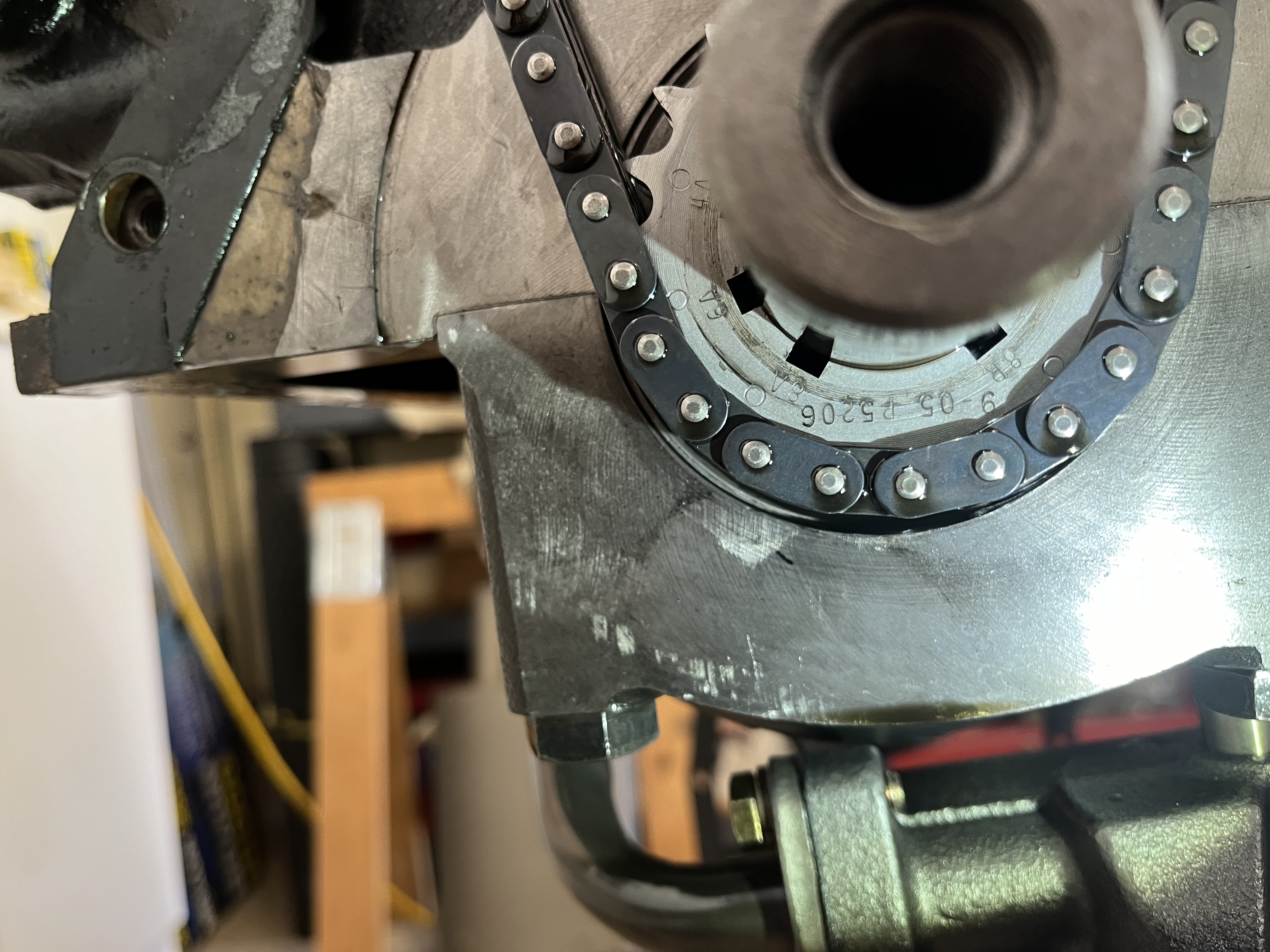

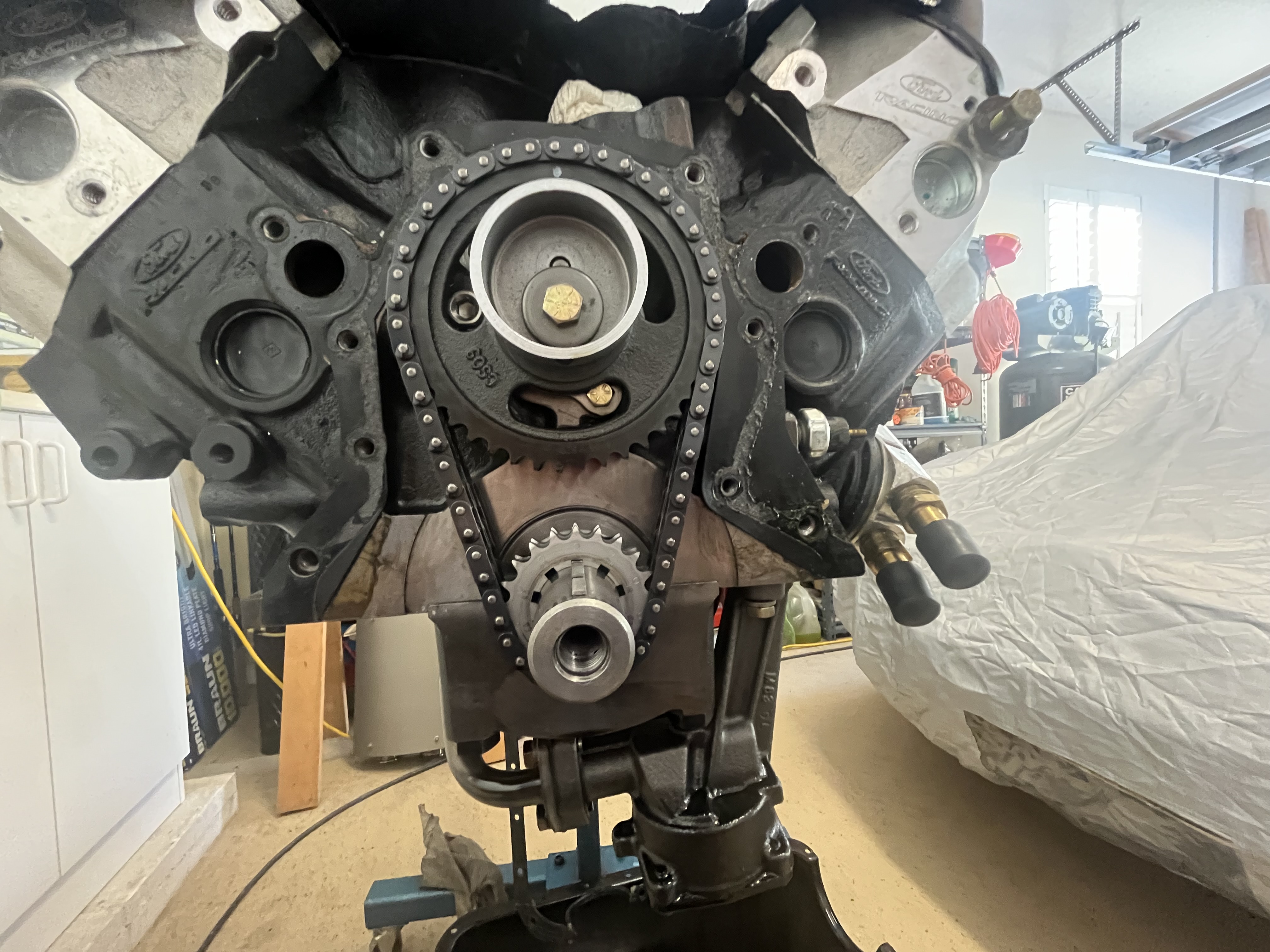

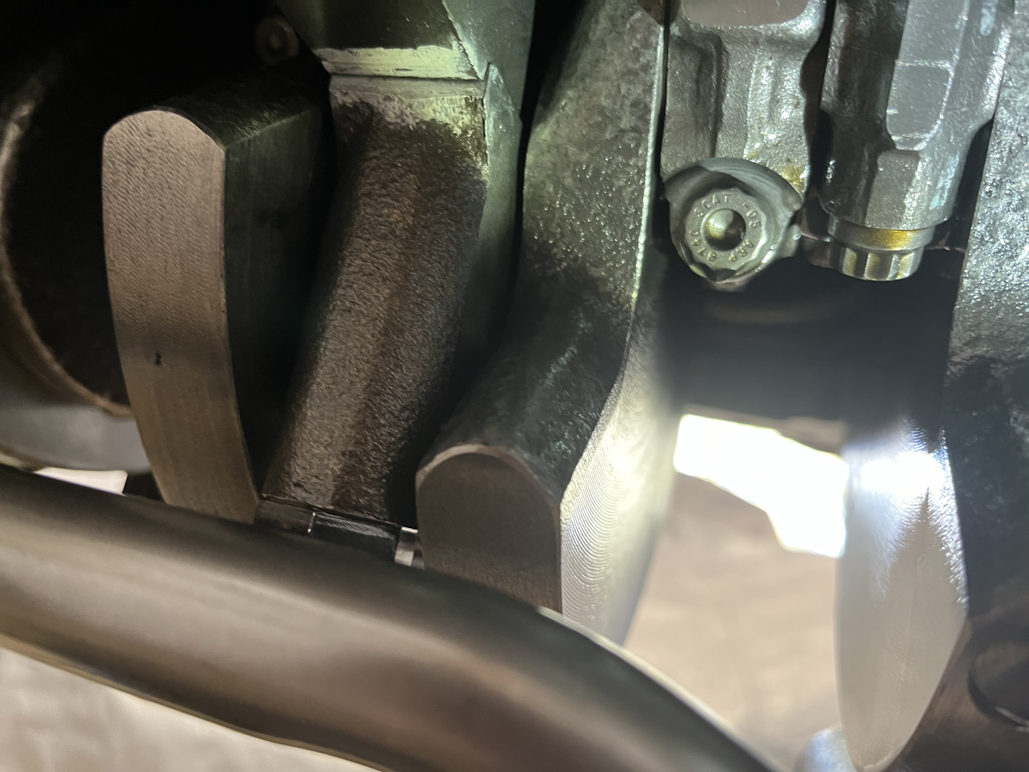

Today I removed the balancer, the timing cover, the timing chain and the oil pan. Everything is clean and tidy as expected for a nearly 18 year old brand new crate motor…😉
Looking into the crankcase I can confirm the pistons are Probe forged, the forged rods are likely Scat as the ARP rod bolts also say Scat. I suspect the nodular cast stroker crank may also be Scat.
From what I can see of the cam gear, it does not appear damaged, but I’ll reserve any further comment until it comes out and I can examine it more closely.

Also, is that a 4-bolt main Ford Racing aftermarket block?
I haven’t opened up the filters yet, waiting to see what I find in the pump and pickup first. If they’re clean, then the bigger pieces didn’t pass through.
I’m anxious to examine the pump, pickup and the cam this weekend, then I can determine next steps and start ordering parts.
Ford Racing 2 bolt Sportsman block.

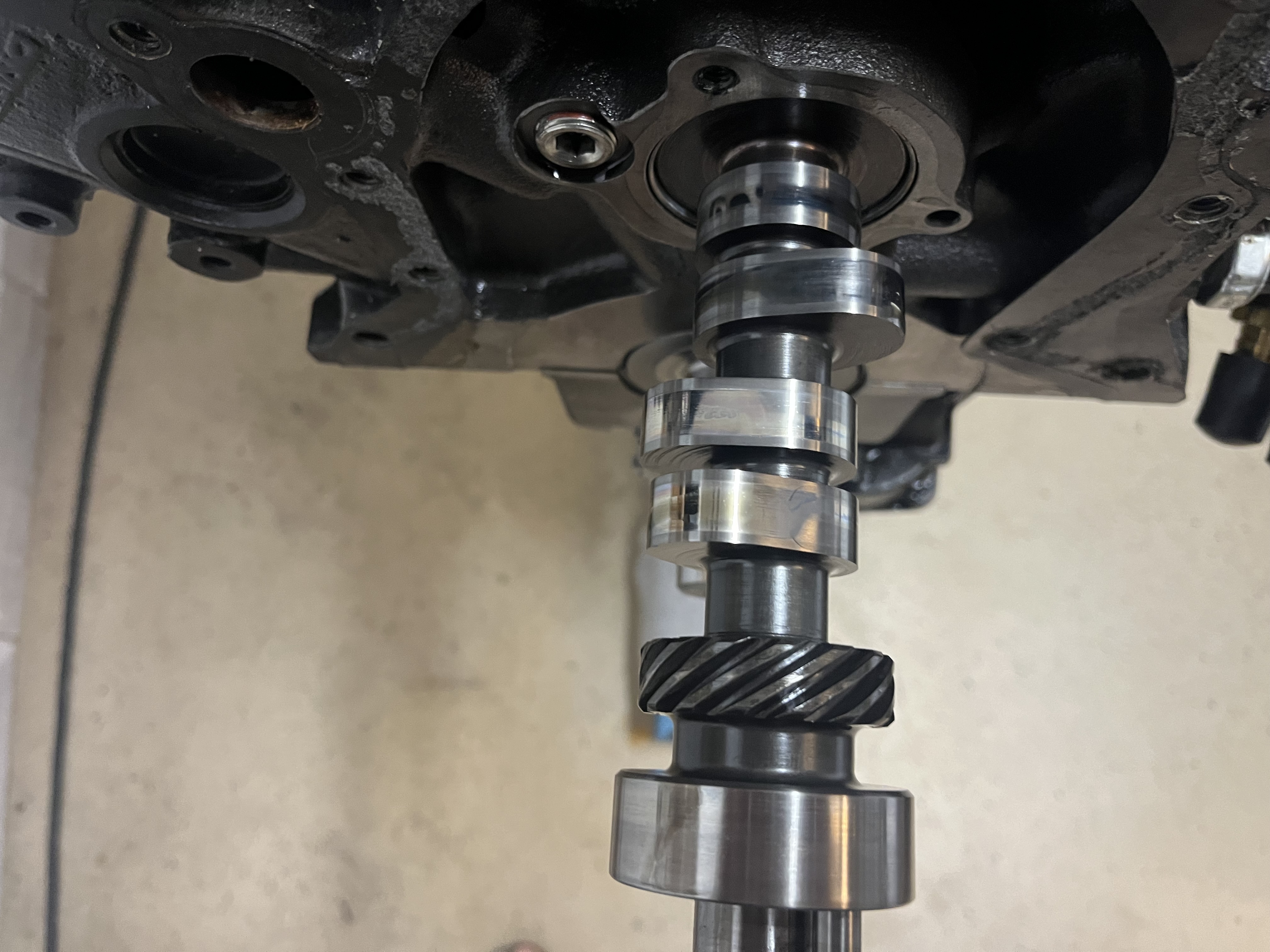

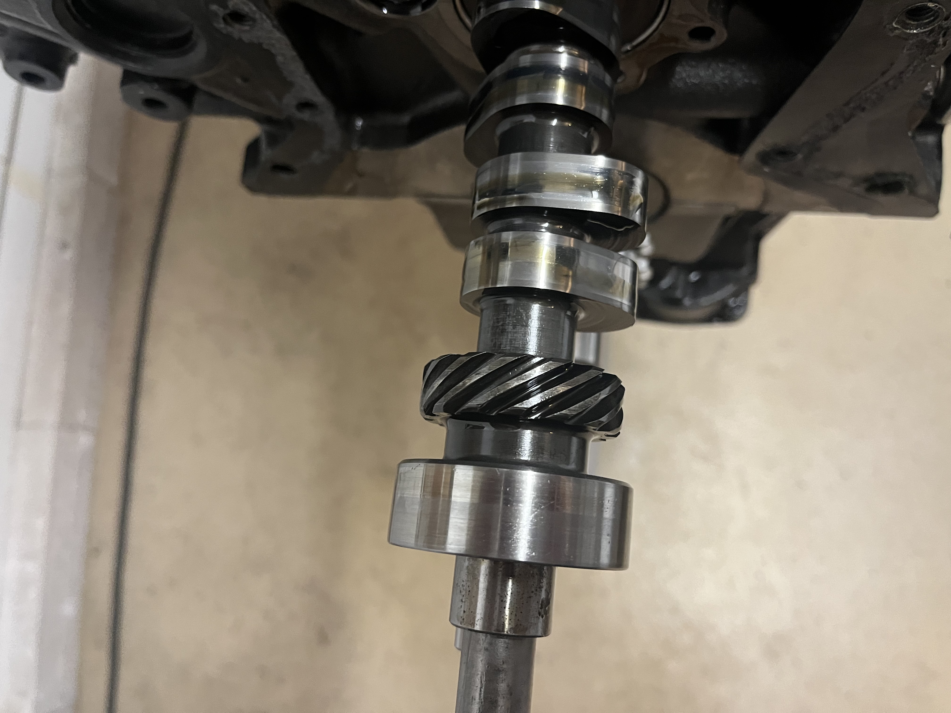

Well, I think I’ve effectively dodged a bullet. The cam gear appears quite serviceable. Barely shows a few minor shiny and scuffed areas, but no chipped, worn or cracked teeth. The only metal pieces and grit from the distributor gear seemed to be isolated to the small forward sump.
The pickup extends to the larger rear sump. I found nothing in the pickup screen or tube. I’ll take a fine hone to the sharp edges and rough spots, but I thinks it’s good for reinstall. Oh, and I dropped in the original, known good distributor, and the gears mesh well and appear fully engaged.
Everything I look at is very clean. I still need to check inside the pump gears, but I don’t expect I’ll see anything concerning at this point and I don’t think I need to disassemble the rotating assembly or remove the heads. Now to start ordering parts and gaskets…😎
That looks like some pretty rowdy lobes on that there camshaft :animals-dogrun:
Yeah, fairly aggressive…😎😎

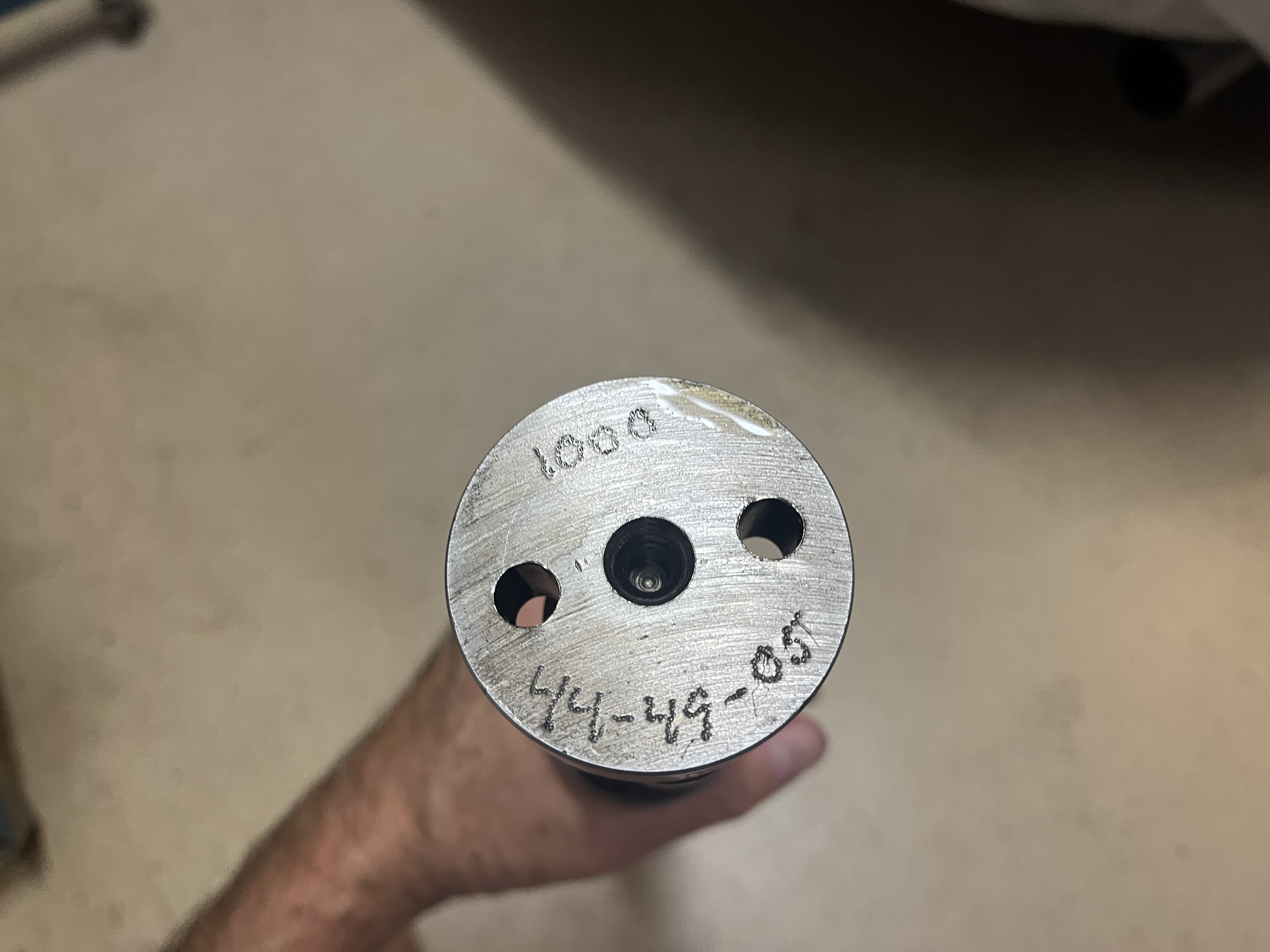

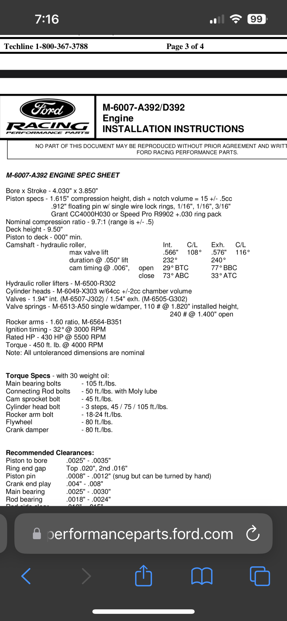

I’m trying to verify the cam specs as listed in the Ford installation doc (attached picture), but none of the numbers on the rear of the cam turn up matching specs. The number etched on the casting between the rear journal and the last lobe is 449359 007711, nothing comes up for this one either…🤔
I think it’s supposed to be XE282HR or similar grind for this motor, but unable to verify.
Cam looks pretty bad ass. Specs. are close to my Thumpr.
Int. 286
Exh. 303
Int. lift .511
Exh Lift 241
However my rocker ratio is only 1.52
Should get the GT down the road real nice.
https://www.motortrend.com/how-to/10518 ... omparison/
Here’s a link to a MT article where they base tested my motor and then tried increasingly more aggressive cams. The base cam actually produced more HP than Ford rated the motor for.
It’s also a pretty good cam for the Webers with 112 lobe separation.
Btw, I assume .241 exh lift is a typo…😉
